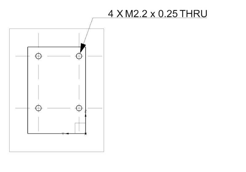

I create 4 hole in a Hole Feature.
But, It's not recognized to Pattern..
In this case, not support the pattern count in drafting->Radial Dimension->Hole Callout Method,,,
And,, Not Support Assembly Pattern,,,
Is this true?
I know solid edge is support this,,,
Why NX is not support?

No,, I created only one hole feature,,,(See my part navigator)
I know, if i create a hole and create a pattern feature, and then support this,,,,
But, hole feature support multi Hole,, And I want multi hole is recognized to pattern..

I would like multiple holes recognized as a 'pattern' as well, but they're not. If you would like to see this behavior in a future version of NX, please contact GTAC and have them open an ER (Enhancement Request) to this effect.
