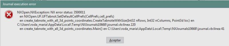

But I cant get that Journal run properly...
always get this message... Any advice what I may be doing wrong?
I have several points in model, hen I start drafting mode, add a sheet, add a view. run journal, select the view, and then journal ask me for tabular note position, I select a point... and crashes.

Also, there are multiple journals posted in the thread that you linked to; which journal are you attempting to run?
