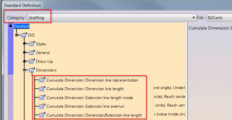

1) I want to know how to give dimensions like as shown in image file
2) There is option to hide extension line but how to hide Dimension line?
3) How to edit dimension value if i enter fake value its color is different this is the only option we have?

For point 2, I think you have to adapt or create your Drawing Standard("Tools" - "Standards.."):
I don't know witch value you have to change.

2) I don't think it can be done, but why do you want to hide the dimension line? If you attach an example of what you want, I'll try to help you

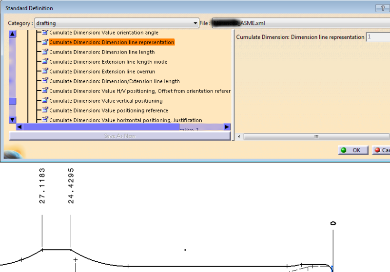

I tried cumulated dimension but I am getting dimension line as you can see my image in red rectangle there are only extension line with value at each point I am trying to get that

I know this before I thought there must be other way because if we can do by above method we can hide any line. And there is no need of option called display extension line
