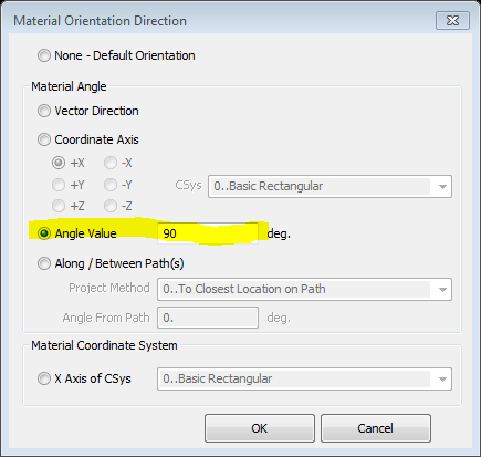

Once I had results I realized that there was a different issue to overcome, however. This one was stemming from the software I was using to create my models. Apparently FEMAP does not work very well with CPLSTN* elements; it does not understand how the elemental coordinate system is defined. It tries to treat them as CQUADs and define the element x-axis relative to the "first-edge". This isn't how CPLSTN* element coordinates are defined however, so when it calculates the element material angle it provides an incorrect result. Does anyone know a way around this in FEMAP? I tried using NX8.5 as well, but it does not support this element type at all (won't even read the elements in).

We are also aware of the material angle issue. Under Modify/Update Elements/Material angle then you should see the form below where you can pick a fixed angle instead of having Femap calculate it. I believe that will allow you to get the material oriented properly.
