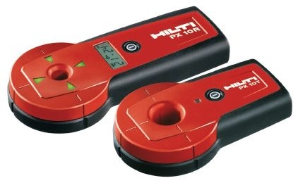

Waterproofing aside, I talked with the Helixfix guys and they believed that a Drill Spotter could be used to precisely locate the studs from the outside. (http://www.firsteditionproducts.com/drillspotter.h...). You locate the studs from the inside with a transmitter which then sends out a signal to another receiver that is aligned on the outside of the wall. Anyone have experience using a similar type of product?

I have used the HILTI PX10 Transpointer, which appears to have identical functions to the "DrillSpotter".
But, I think if I you re-read the DrillSpotter specs it will NOT locate the studs, it simply enables you to determine the exact location of the transmitter centerline to the receiver centerline, and the distance between them (i.e. thickness of the medium you are transmitting).
I have owned the Hilti transpointer for many years and it is a highly accurate and indispensable tool. My main use is through reinforced concrete floors and walls.
You are still going to have to find a method to non-destructively locate the wood studs, then determine the stud width, then locate the stud centerline, then use the transpointer to align the interior centerline with the exterior centerline, then drill a somewhat precisely aligned hole from the exterior to hit the stud. Big ask, in my opinion.
