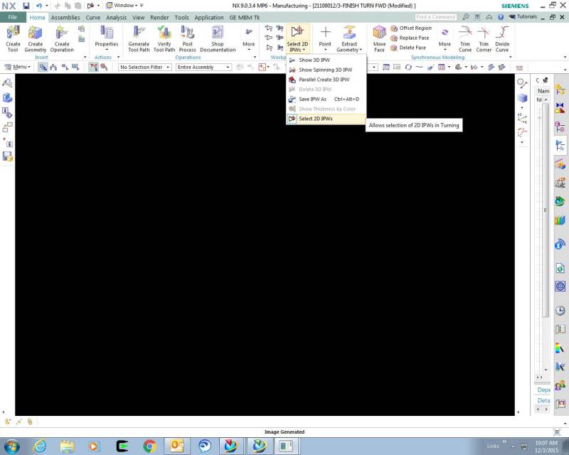

In NX7.5 (Manufacturing - Turning) you are able to measure a distance using using the IPW
This does not appear to work in NX9 and cannot find the preference setting to do this in NX9
Nothing is highlighted when hovering over IPW
Screenshot is using one of the NX7.5 turning examples from training
Is this function still possible in NX9 or has it been lost during the update ?
RE: NX9 measure using turning IPW
You need to turn on Select 2D IPW
KMCC - Thanks that has worked
Unfortunately, I seem to have to do that every time
I open the part.
It should be retained in your dialog memory.
