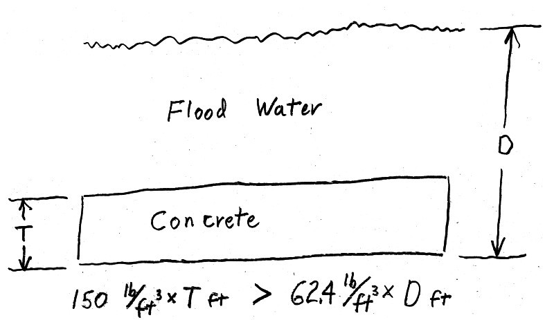

Dear Friends and Technical Experts.
I was assigned a task to dry flood proof an existing one storey building. I have calculated the dead weight of the building which counteracts the floatation forces. But the issue I have is the slab on grade.
with 2' of flood water the buoyancy forces are high on the slab. The slab is 4" thick and is not connected to the exterior walls. The client does not want to increase the slab thickness as they have to move all the interior walls and kitchen equipment and misc electric systems.
I have 4" slab weighing 49.5psf and I have 124.8 psf buoyancy force. I need to counteract 75.3 psf upward force.
Has any one used floor anchors before and if so can you suggest a manufacturer or a detail?
Wet flood proofing is not an option for the client.

124.8 psf is the weight of the water, it is not the buoyant force. Solid concrete objects due not float since the unit weight of concrete is (usually) more than the unit weight of water. Usually you only get uplift on concrete structures if they are in the form of a tank or other hollow shape. Calculate the weight of the slab and the weight of water displaced by the slab, then compare the two and you will see that your slab will not float.

RE: Dry Flood Proofing and Buoyancy
Hi All,
thanks for your suggestions. In the book "FEMA 259 Eng Principles and Practices for Retrofitting Flood Prone Residential" by FEMA. in appendix C page C-7 it was mentioned to use floor anchors. I was checking if any of you had experience with anchoring the floor.
See attached screenshot.
http://www.fema.gov/media-library-data/20130726-15...
Unfortunately the client does not want to increase the thickness of the slab but will try to convince.
HI all,
The client agreed to provide new slab in the building. Now I got one more confusion. When I calculated my initial buoyancy I used 62.4*2'-0". (2' being the flood water height0
I achieved that a 10" thick slab is required. Since I am using a 10" thick slab should I again reconsider using 62.4*2'-10" for my buoyancy? Because water pressure acts at the underside of the slab and not at finish floor.
If I do that, then the iteration ended at requiring 16" thick slab = 200 psf dead load. + misc interior wall non load bearing loads
flood load buoyancy = 2' flood water height + 1.33' thickness of slab = 62.4*3.33=207.7.
Is this correct or am I going crazy. I have never used a 16" thick as slab but used it like a raft foundation on a very small building.
Please suggest.
Bala0404 - Don't worry, you are not "going crazy". You are making the problem appear more difficult than it is, by using terms like "flood water height" and "thickness of slab". The trouble is those terms are relative, not definitive. As floor thickness changes it is not clear to us what happens to the flood water height.
Instead consider the elevations of both the water surface and finish floor. If you do that, then the flood water height and thickness of the slab are tied to each other. The "answer" for the minimum concrete thickness (to prevent floatation) then is defined by the simple relationship shown in the following sketch:
www.SlideRuleEra.net idea
Quote:
BASED ON THE ABOVE CALCS I HAD TO MAKE THE SLAB 16" THICK SO THAT THE SLAB DOES NOT FLOAT.
Well, it's not that the slab will float but that the overall building would not float.
MotorCity above already pointed out that concrete doesn't float.
So the question is - did you include the weight of the building itself in your calculations?
If the slab is adequately attached to the perimeter building walls, then the buoyancy pressure would push up on your thick slab which would be held down by its own weight and also the load on the perimeter of the thick slab. So the slab would then try to span between these heavy walls, bowing upward in bending. You can design the slab to resist this upward bending if the span isn't too long.
With a 16" slab I would think that it could span up to 20 to 30 feet. The perimeter shear connections might be tricky.
