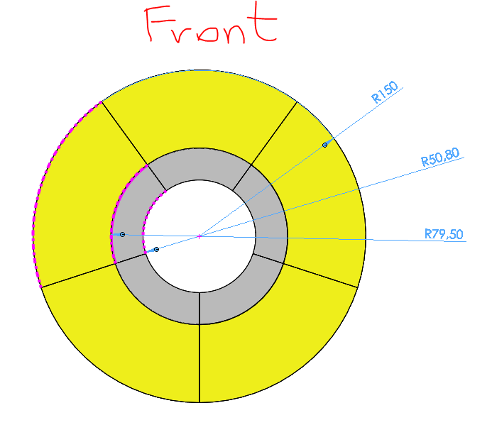

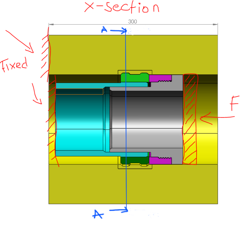

I've got a task where i need to use manual calculations with this setup (see attach.)
there is a cylinder with two internal grooves (yellow part). 5 Dogs are equally spaced (72deg.) inside that cylinder. They are being pushed by the Force against the grooves in the cylinder. What stresses i have to calculate to make sure the construction is stable with applied Force. And what equations I need to use.
Kind Regards, S.

SergeyZh:
From your sketches and verbal description so far, it is pretty hard to know what you’ve really got there. Some better sketches with good proportions, dimensions, sizes, thicknesses, several views, forces, etc. would go a long way to explaining your problem. What’s the cylinder dia., the dog teeth sizes and thicknesses? How are the dogs attached, and to what? I share TGS4's concern for your lack of first principles and fundamental engineering understanding of Strength of Materials. You say... “I need to prepare calculation thru the stress equations manually how we did at school.” What school, and did you actually do those homework problems, that semester? Have you looked in your Strength of Materials or Machine Design text books before asking for help here. You will learn more if you have to dig, study and think a little bit, as opposed to being spoon fed here on E-Tips. A few questions for you to ponder and come back to us with your answers. What’s the shear stress in the dog teeth? What’s the bearing stress btwn. the dog teeth and the cylinder grooves? What’s the preferred angle for the teeth and groves, and clearance btwn. them? How many of these dogs and their teeth act in unison to take the total torque loading? Can either the dog teeth or the cylinder flex out of their normal shapes and positions under these loads? Show and explain your answers to the above questions, and we’ll critique them.

I am still trying to figure out what he has in the two sketches. I agree with dhengr that the sketched are deplorable. Proper sketching requires top, front, end and section views or an isometric view with a cut section for this post.

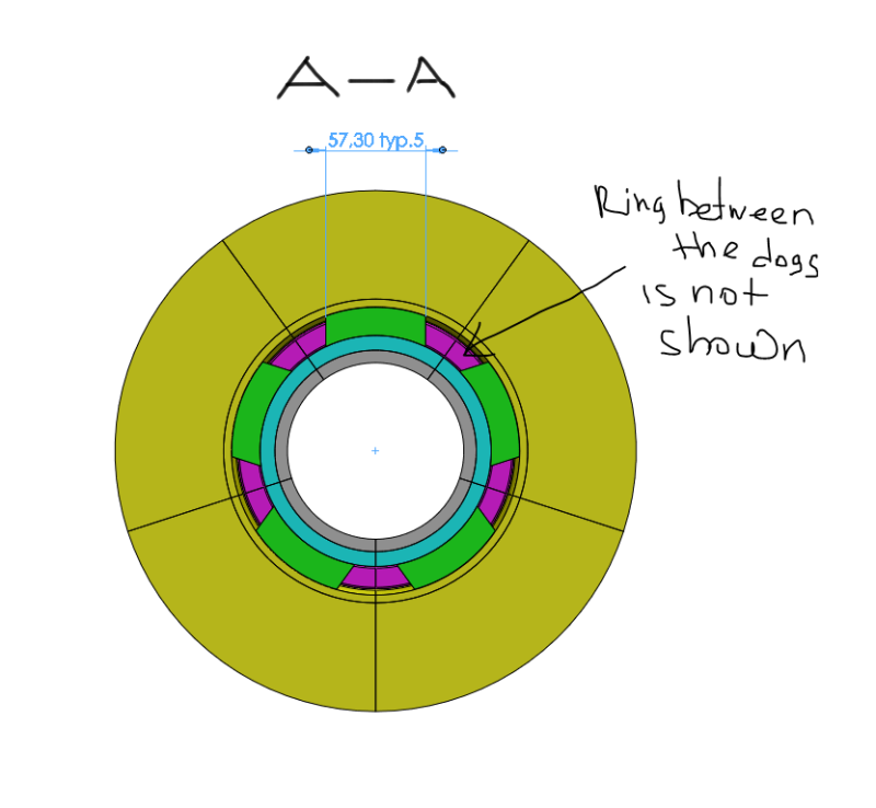

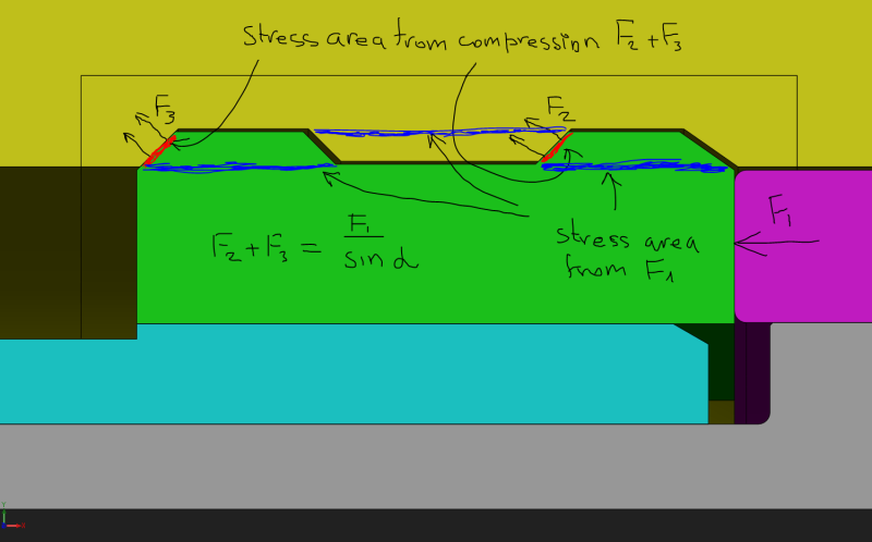

It seems the opinion here has built that I'm nooblet smile. I just wanted to confirm what I'm going to calculate is correct. Here is more detailed screen shots. Am I right with the last screen shot?

The arrangement you show is very complicated. Have you considered factors such as tolerance stack-up between the mating parts? Under some conditions it would be quite possible that only 1 or 2 of the dog rings would carry the load. Or that the two threads of each dog sector will not share the load equally. Have you accounted for the end moment friction produced on the dog ring sectors when the thread joint is tightened?
RE: Shear stress or more
What is holdong the five dogs in their place. What if the dogs will thrust to one side of the ring?
Also check the contact pressure form F2 when F3=0 and F3 when F2=0

There may be hoop tension in the outer section to be considered given the sloped portions...
IFRs
Could you please draw the area on my sketches where possibly the hoop stress may occur.
