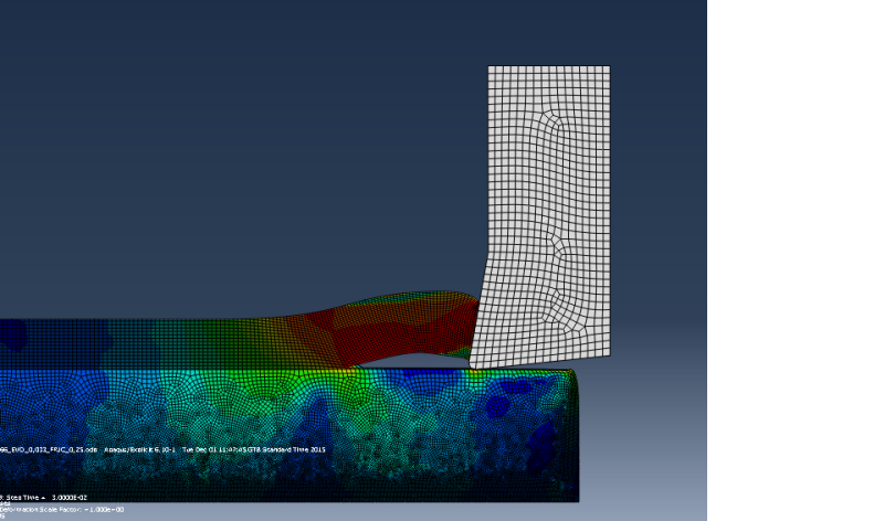

could someone enlighten me regarding the equivalent plastic displacement parameter input? My material is defined with the Johnson-Cook model
but I cannot seem to find an accurate way of calculating the equivalent plastic displacement.
The problem I am trying to simulate is a 2D orthogonal cutting example with a rigid tool.
By using a displacement I have calculated based on the element characteristic length, the result I get is as follows:
As it is shown, my chip has been lifted from the workpiece way too early which is a mistake for this cutting speed and these materials.
I think it has something to do with damage evolution but every other opinion on the matter would be highly appreciated.
