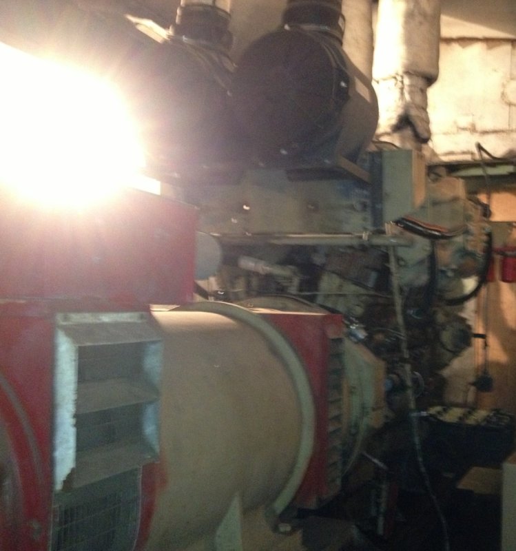

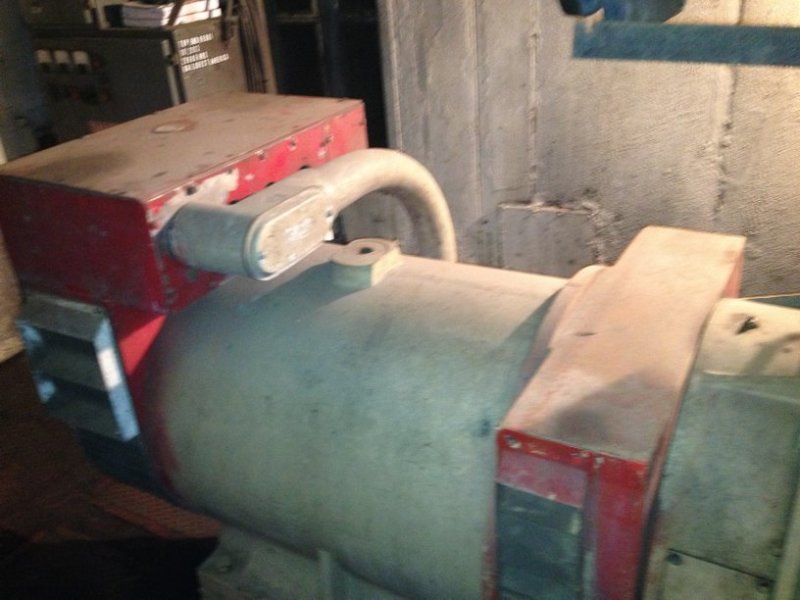

Finally someone (not me) got some pictures for your esteemed review.
I'm still grappling with the 12Vdc field suggestions because with more investigation (but probably not enough) the 125Vdc Basler regulator that was taken out appeared to be the original unit buried deep in the panel bolted into original looking holes etc.
Here's to figuring out if this machine has a coaxial exciter generator:
Still think its a Newage Stamford tailend?

That is most certainly a Stamford gen end...can tell by the shape of the fan and bearing housings. The exciter armature will be mounted on the rear of the main rotor. There is no PMG, indicated by the absence of a large protruding cover on the bearing housing.
I am curious as to why the VR902 is being specified as the replacement regulator? Does the customer use this model as a standard replacement? Not that it is necessarily a bad choice, I'm just wondering because there are several regulator models that would work. As Mike said, the AVR specs are just the maximum rated--it doesn't mean the AVR will necessarily ever reach the rated field output in actual operation.

Looking at your first picture, we see the end of the shaft and the Non Drive End bearing. A PMG set will have a short shaft extension past the NDE bearing and the PMG will be mounted there and will cover the NDE bearing. The end of the shaft is not visible with a PMG fitted.
