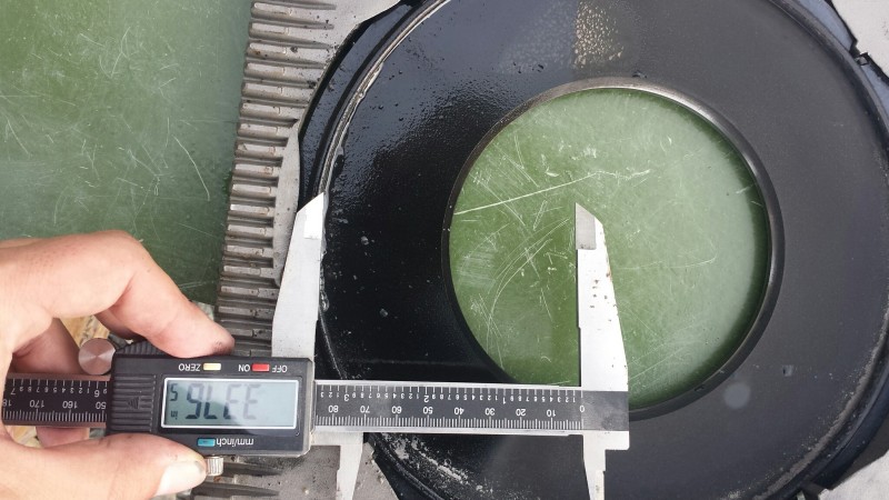

zdas04, not to stray off OP but when you say water dams, are you talking about something along the lines of the below picture? This is an 8" plate pulled from a meter that had been in service for about three weeks. It sure seems like a big problem.

It does seem like a big problem, but ask yourself "how did the water line get that high on plate without all the liquid running through the hole?". The answer is a 50 gallon (for example) slug hitting the plate and over 50 mS splashing around until it was gone. What I found in my experiments is that you never end up with a liquid reservoir standing upstream of the plate because the energy required to maintain the fluid level is too high to be sustained. Liquid wants to run back down the inlet piping (when the supply pipe comes up from the bottom) or it changes flow regime and splashes out.
In my experiments the actual magnitude of the problem (because of the very short duration transients) was far lower than the damming line would make you think.

Was the OP in the photograph installed backwards?
Presumably, the dark, blackish coating is evidence of the water dam on the upstream side of the OP.
The bore surface is somewhat visible on the right side from about 1 o'clock to 5 o'clock.
Isn't the concentric ring (reflective surface at 12:30 to 1 o'clock) adjacent and to the outside of the bore surface the downstream beveled edge?
RE: Orifice meter max differential pressure maximum question
That is what it looks like. I've never seen a water dam on the downstream side of a plate.

The plate was note installed backwards. Look at the gear teeth on the plate carrier. The gear is on the downstream side, same as the beveled edge. It is strange, I'll admit. And I do not know enough about the process to understand why. But having pulled the plate myself, I can tell you that it was installed correctly with the beveled side facing downstream. Perhaps standing water? I will look through my pictures. I should have pictures of the upstream side as well, I will look for that.

Here is the upstream side.
Thank you for sharing. I really have never seen a pronounced liquid dam on the downstream side of a plate, but (actually) that is the only way that the dam height could be so far above the minimum of the orifice hole. Could the piping into and out of the tube be up instead of down or horizontal like AGA 3 recommends?

I am not sure what you mean by if the piping is up instead of down or horizontal. The inlet piping comes up out of the ground, passes horizontally through the tube, and then back down the outlet. We have our plate carrier roll out horizontally instead of vertically. Is that what you were asking?
No, I've seen a couple of stations where the piping comes down out of a separator into the top of the meter run and then up to a pipe rack. They never work very well.
The piping you described should not be able to support the dams that are clearly visible on the plate. Developing a scenario that matches the evidence will take a bit more pondering.

There may be some piping reducers in this horizontal metering section with reducers oriented bottom flat, or some other piping fittings which create a low point that encourages condensed liquids to pool up at the meter, maybe a dual disc check valve etc?
Sorry for bringing up such an interesting scenario! The piping that comes up out of the ground only has concentric reducers. We have 12" headers for this 8" tube. So it is reducing down from a 12"-8" concentrically.
