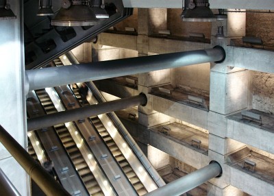

Westminster Station in London uses a diaphragm wall as the permanent structure. The wall had a grillage of concrete beams cast in front and then massive steel props installed. This was required as there are no floor slabs in the escalator zones to provide lateral restraint.
A well constructed wall should be waterproof (but may be damp). Grout injection through the wall can be used to patch up any local leaks.
