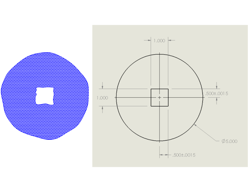

I have a disk that is inserted in a cylinder. A square sleeve will be inserted and welded to the square bore of the disk and I am trying to center the hole on the disk. Is a position tolerance the best way to do this? I have read that you can use position with any feature, not just a circle. Even though it is a square, the diameter callout still seems correct to me as the tolerance zone.
Otherwise, setting an X-Y tolerance on the distance to the centerline would give a similar result. I guess the only difference there is the square vs circular tolerance zone.
Is this correct? Thank you.

Yes, a circular tolerance zone of Ø.030 would be appropriate given the tolerances you show.

ewh -- what is it that we want to fall within that diametrical zone?

Derived axis/center of a square. Or better we use Concentricity?

I believe what John-Paul is getting at is how to deal with the form error on part surfaces:
On the irregular hole shown, several different derived axes/centers are possible (as well as several different centerlines for the OD). Given the tight tolerances, the magnitude of the irregularities could be in the same ballpark as the tolerances.
I'm also wondering - why is the location tolerance for this hole so tight, if a square sleeve is going to be welded into it?

If I remember correctly, axis is derived from mating envelope and not the actual surface.
RE: Position Tolerance of a square feature on a disk
Yes, I realize that an axis is derived from UAME, so form wasn't the issue. (Thanks anyhow, Evan!)
But ... what is the axis? The center of the AME from the vertical walls and then the center of the AME from the horizontal walls, then taking the intersection of those two planes? Or maybe a perfect square that expands until it hits, what, 3 points? (This seems to be an "irregular feature of size" if I can throw that term in here.)
The standard would normally say in a instance like this to default to the boundary interpretation. Yet the OP doesn't want that because the thing has to be centered in a circular fashion.

If I can safely assume the usage of the part (big IF) I would say it would be the center point of the biggest perfect square that fits in the square hole. How to accurately convey that through appropriate language, though, I would have to think about more.
All excellent points, and I will answer what I can. This is a very simplified example of the actual part. We currently use a round sleeve but have had years of problems and I am now looking at a square sleeve. I have a few options, but I need to at least get this one quoted. We did have problems when the circular sleeve was not centered and the shaft would move and cause failures. I need that shaft to be as centered on that disk as possible.

Sounds like a job for concentricity of the square relative to the OD.
Or locate the OD relative to each width of the square.

I'm not sure that your latest possibility works:
-The two directly toleranced width dimensions are not compatible with the profile tolerance (the dimensions should be basic)
-The position tolerance would only apply to one of the widths. I think it would need another position tolerance for the other width.
This gets into several gray areas. I'm not sure what happens when a position tolerance referenced RFS is applied to a width that is controlled by a profile tolerance. It's defined when referenced MMC, using the boundary position concepts, but I'm not sure about RFS.

2X applies to both dimension and position. The frame can be moved to the right to make it more obvious, but it won't really change the meaning.
The square has 4 implied basic 90 deg angles and profile controls orientation of square sides to each other.
No, dimensions shouldn't be basic. No, the width is not controlled by profile tolerance.
In fact, when you see profile applied to feature without basic dimensions, it is clear indication that profile controls form or/and orientation.

CH -- you clearly made the profile "all around." So the width is being controlled by the profile tol. Thus, the dims have to be basic.
