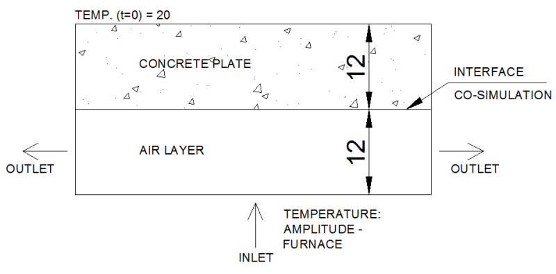

I simulated a interaction between an air layer (12 cm) and a concrete plate (12 cm). My doubt is:

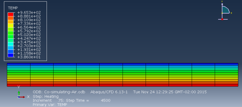

1) The temperature gradient between the top face and the bottom face, of the air layer, shouldn't be smaller, after 75 minutes? (see Annex 1). I am finding a difference of 900 degrees.
I think, after a time, this air layer should have the same temperature, in top and the bottom faces. I expect to see it.
Boundary condition utilized in Air Layer:
- Inlet: Temperature = Furnace (see Amplitude)
- Outlet: Pressure = 0
- Co-simulation = Interface between air layer and concrete plate
Abaqus File (Plate.CAE): Link
Abaqus File (Plate.JNL): Link

Annex 1 - AIR LAYER results:

The temp of 965 is defined by your BC. So Abaqus has to apply that.
Air-Model -> BC Inlet -> Magnitude=1 with reference to an Amplitude.

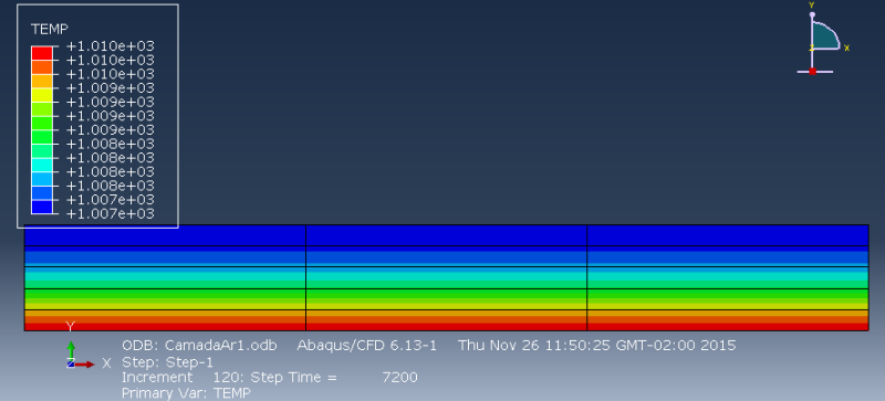

My doubt is, after 75 minutes, why this layer (12cm) isn't uniformed? My point is, I expected to see a thermal gradient less than that found (900 degrees).

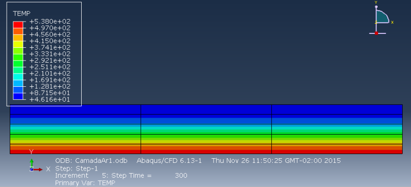

I simulated only the air layer (without the concrete plate). See the results below (5 and 75 minutes).
Fire test after 5 minutes - the air layer isn't uniformed.
Fire test after 75 minutes - the air layer is uniformed.
