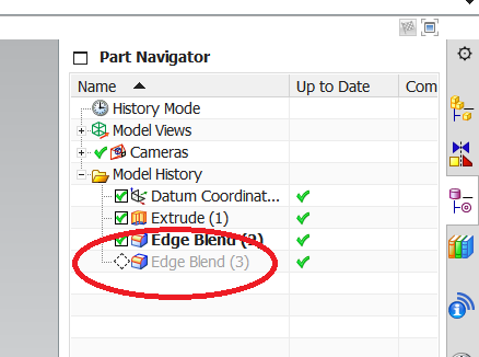

How to use active/Inactive feature in NX, Because in my file one feature is inactive so i want to active it. But i don't know from where i can do it

I suspect that the so-called 'inactive' feature is the last one on the list of features in the Part Navigator like in the image below, correct?
If this is what you have, simply select the 'inactive' feature using MB3, and then select the 'Make Current Feature' item from the pop-up list of items.

I got it, Thanks for helpthumbsup2
