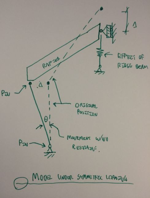

1) I believe the reactions delivered by the rafters to the supporting structure to be unrelated to whether or not the bearing surface is flat.
2) Since the supporting wall is pinned top and bottom, there can be no lateral kick at the wall. Only unrestrained lateral movement.
3) Since there can be no lateral kick at the wall connection, there can also be no lateral kick at the ridge beam connection.
I believe the model shown below to be the appropriate way of visualizing the typical rafter condition. I forgot to throw in some load but you`ll get the idea.

OK. I understand the diagram to show how the ridge beam deflection will translate into a lateral deflection of the wall. No worries.
However, stand an uncut rafter on the outside edge of a wall top plate and the outside edge of a ridge beam and see if it stays there. NO. It will slide. The steeper the slope, the faster it slides.
Bottom line is that there must be a horizontal component that has to be dealt with. That is why we use flat bearing if we can at the ends of the rafters.

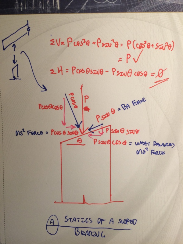

I agree with the outcome of this mental experiment. However, it is missing a crucial feature. It assumes the absence of BA's shear parallel to rafter force. If you reintroduce that force, as would be required for equilibrium, you will find that the net lateral force on the wall is no force at all.
The sketch below shows my statical analysis of a sloped bearing condition. In essence, it's a convoluted way to say that you can't squeeze a horizontal reaction out of a vertical applied force.
Quote (msquared)
That horizontal component is dealt with, internally. I think that we use flat bearing seat for two primary reasons:
1) Who the heck wants to bother ripping a tapered top plate.
2) Per the comments by BA & XR250, the flat bearing surface eliminates the need to transfer shear parallel to the bearing surface, at least for gravity loads. Clearly, you'd still need to for wind and seismic.
I suspect that real reason is overwhelmingly #1.

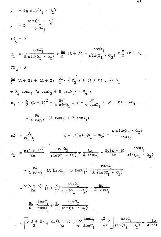

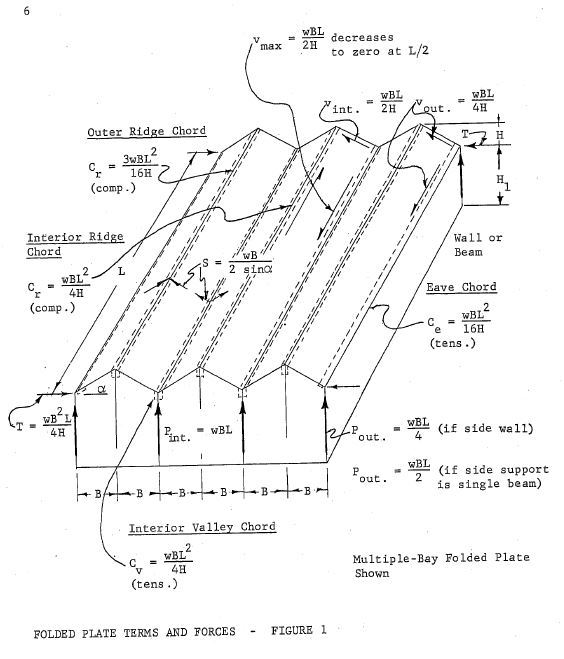

1) Yeah, the roof diaphragm does something for the system. Per the document below, we've been talking about this since the early 70's at least. We debate the merits of diaphragm action here regularly and, occasionally, rely on it out of desperation.
2) As structural engineers, our wheelhouse is less "what works" and more "what can we prove works". I'm not about to tell a family living under a KootK stamped roof that they shouldn't worry about having a ridge beam because I haven't seen any examples of them failing on the interweb.
3) Per the document show below, which contains about 100 pages of typeset algebra, proving that folded plate works is really, really, really hard. And getting the designed details properly executed in the field is even harder.
4) One thing that you may not be considering is that these great, deep diaphragm beams require supports at the ends to act as such. Those supports are generally the shear walls at the gable ends, one of which is usually chalk full of windows. If the top plates are spliced together carefully, one can take advantage of symmetry to solve this problem. It deserves special attention however.
