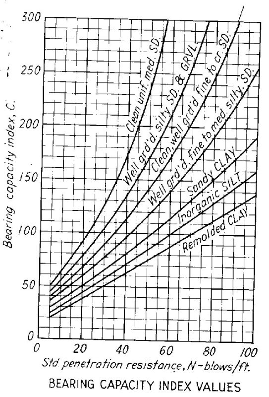

As to the sizing of footings for equal settlement, one may try to use equal bearing pressure, but that is not very precise. Instead, I'd get back to the geotech and provide the column loads for each situation and the footing grade. Ask for a specific determination of footing size for each column load based upon an actual settlement analysis for each situation. Ideally they would provide a chart showing a plot of lines of equal settlement with the ordinate as column load and the abscissa the footing width. While they may want to run consolidation tests, they may be able to estimate these consolidation test results and come closer than you can with equal bearing pressures.
An old paper by BK Hough provided relationships between N value and some of the values used for these settlement analyses.
ASCE SM 4, # "Compressibilit5y as the Basis for Soil Bearing Value". August 1959 His value C=1+e/Cc called Bearing Capacity Index
