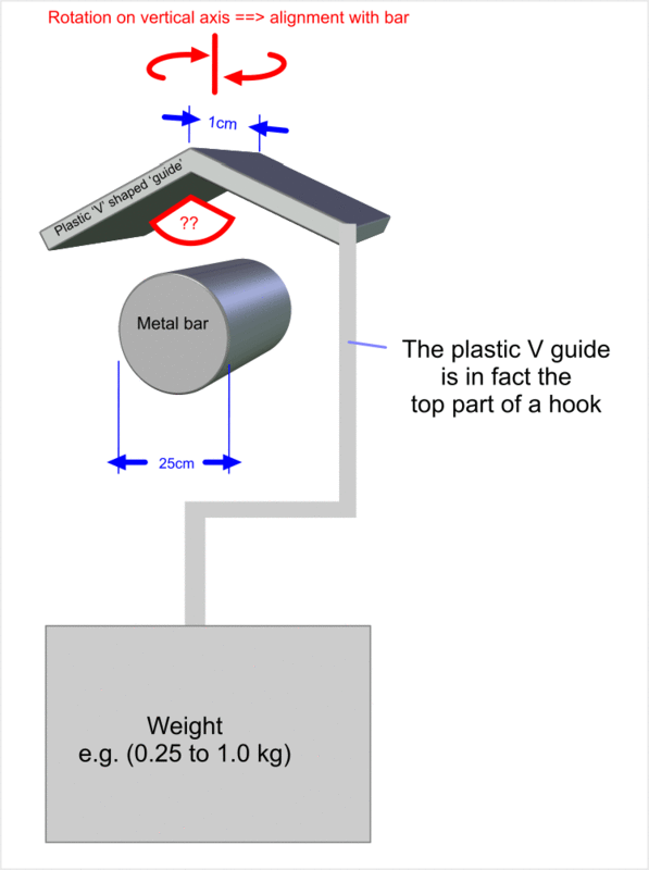

Hello
I am new. I have simple a mechanical design problem:
1. I have a cylinder - i.e. a round bar - that is 25mm in diameter and made of polished metal (chrome).
2. I have an inverted V shaped guide made from smooth plastic (probably polyethyline PE or similar. This inverted V will be fairly short - only 10mm (1cm) deep.
Now, the plastic inverted V shaped guide will be resting (unsupported) on top of the round bar, with a light force equivalent to say 200 grams, and it will be able to twist along a vertical axis.
My question is this:
How shallow can I allow the angle of inverted 'V' to be and still expect the V to rotate so as to align with the direction of the metal bar? i.e. to point in the same direction. (The alignment of the two objects only needs to be within a few degrees)
To explain:
If the V is extremely steep say 45 degrees - or even 90 degrees - then it would be reasonable to expect the V to align EXACTLY with the bar. But if the V is very shallow and starts to approach 180 degrees, then one would not expect the V to rotate at all.
Are there any rules of thumb or guestimates that I could use?
J
P.S. Please excuse the very crude nature of the attached diagram, but I hope it brings the problem to life...

Make the included angle 120 degrees. The ramp out force will be .58 x the weight.

If there is no friction opposing rotation of the guide, and for small angles of mis-alignment, the problem reverts to a simple "mass holding on a slope".
So mu = tan(slope) and included angle (your problem), I = 180 - 2 x slope. (I = included angle)
So I = 180 - 2 x tan^-1(mu)
eg
mu = 0.1 gives I = 168.6 deg
mu = 0.5 gives I = 126.9 deg
mu = 1.0 gives I = 90 deg

RE: How shallow an angle of V would still align with a round metal bar?
Looking at tables of friction coefficients, I see .20 as worst case. Therefore, minimum angle for impending slide is arctan(.2) = 11.3 degrees. The maximum included angle would be 180 - 22.6 = 157.4 degrees. The included angle must be less than 157.4 degrees in order for the V to slide to align with the cylinder.

OK let me try and get my head around this.
1. Shallow 'compass bearing' angles
In the starting condition, if the top of the hook - i.e. the plastic (inverted) V - has been rotated horizontally to be aligned at a pretty extreme compass bearing (e.g. say 20 degrees) away from that of horizontal bar - then, given a reasonably steep V and a fairly low amount of friction between the plastic V against the metal bar then my assumption is that the V will definitely rotate towards a better alignment with the bar.
However the problem starts when the compass bearing between the V and the bar is more shallow, being as the corrective angles will be much more shallow.
2. Tighter alignment needed
I've run my geometry again and the bad news is that I need much tighter alignment than I had previously thought. Ideally as little as +/- 2 degrees would start to become a problem. So I am really looking the plastic V to come to rest at +/- 1.5 degree from the compass bearing of the bar.
3. Hydtools's calculations
I'm not quite sure what went into the 157.4 degrees calculation (it's is a pretty wide looking V either way). Is it the steepness of slop at which a down which an object (in simple terms think 'toboggan'!) would start to slide?
If so maybe we could find a way to use that. However the complication is that we need to get this angle calculated correctly - and this is NOT straightforward. Not least because the closer to true alignment of metal bar and V-shaped plastic, the smaller this angle will be. (This will be due to the fact that the plastic can only rotate around a vertical axis due to the weight at the bottom of the hook [although see Real World Experiments below, talking about swing.)
4. A possible simplification
One thing that might help is if we were to assume that the thickness/depth of the V was extremely narrow (approaching infinity - but still deep enough to have significant friction). Any increase in depth (Z direction) will help correct, so if something can work at a very thin (e.g. 1mm) Z depth, then it should work with my actual model.
5. Real world experiments ==> swinging
I have done some simple tests with a crude prototype and during the time when the weighted hook (containing the plastic V) has first been put on the metal bar, depending on exactly how crudely it has been hooked onto the metal bar, despite the fact that there is quite a lot of dampening by air, it will swing always back and forth a number of times. With fairly smooth surfaces this can easy be as many as 12 swings in the Y direction (see diagram). The air dampening in the Z direction is greater but that can swing a number of times too.
What I have only now released is that whilst any of this swinging is still happening, because things are already moving small corrections to the alignment become possible that would not have happened during static conditions.
[In hind-sight this is quite obvious - it's just that I hadn't realized how many swings would happen when the hook is weighted.
Here is a slightly improved diagram:

Extremely narrow z, approaching zero, not infinity but knife edge, there will be infinite z swinging neglecting air damping friction. Increasing z dimension will increase resistance to z swinging.
Decreasing included angle will increase aligning force. X swinging will be damped by sliding friction.
What are your post-hanging motion requirements? Something more than just aligning the V to the bar?
Observe clothes hanger motion for clues.

where d/db(H) is the first derivative of H with respect to beta.
I believe, but cannot readily verify mathematically, that this torque is smallest when beta is vanishingly close to zero.  Under these circumstances d/db(H) can be shown* to be
d/db(H) = L/(2*tan(alpha))
and so
Tg = WL/(2*tan(alpha))
(*Being lazy, I did the calculus using the venerable Derive computer algebra program.)
Another result that comes from simple statics is that vertical equilibrium requires that the (radially directed) normal contact force between the vee and the bar be given by
N = W / (2*sin(alpha*cos(beta)))
at each of the two contact points.
Now think about friction.  The key question is whether the friction is capable of generating a resisting torque that is equal to the gravity-induced restoring torque Tg (perhaps throwing in a factor of safety for good measure).  The maximum possible friction force at each of the contact points is u*N where u is the coefficient of friction and N is as given above.  This will be oriented directly opposite to the direction of the relative movement, but the direction of relative movement is not easily calculated.  Assume, probably slightly conservatively, that the direction is the one that leads to the maximum resisting torque.  The frictional resisting torque will then be given by
Tf = (u*N) * (distance between contact points)
   = (u*N) * ( L/cos(beta) + 2*R*tan(beta)*cos(alpha*cos(beta)) )
For our case of interest, the case where beta is vanishingly small, this simplifies to
Tf = uWL/(2*sin(alpha))
If the calculated value of Tg exceeds that of Tf by a sufficient margin, then we can be confident that the vee will correctly self-orient itself on the bar.

There is an error in my diagram.  The hand-written expression for H1 should be
L*sin(beta) / (2*tan(alpha*cos(beta)))
This problem applies only to the diagram, and results from a careless transcription error when I created the higher quality diagram from the crude scratchings I had used when doing my algebraic manipulations.  The algebra in the text of my above post is unaffected by this error.
