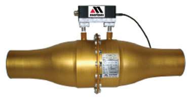

With transitions, the ideal shape for minimum restriction is an S curve. Laminar flow element installations provide a good example:
The higher the aspect ratio L/D, the lower the restriction, but a point of diminishing returns is reached and the LFE example is probably a reasonable compromise.
