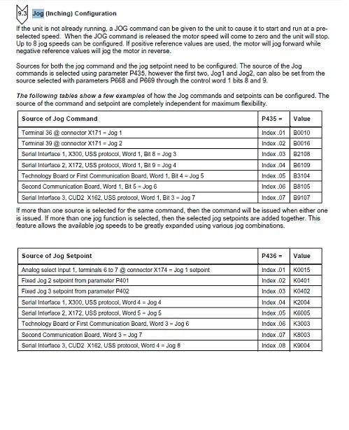

Hi. I have installed a Siemens 6RA70 DC Drive. I cannot do jog operation in it. How to assign terminal 36 or 39 to jog operation. And how to set jog speed via parameter. Thanks.

Hello
Have you considered fixed setpoint injection on page 10-46?

I tried but failed to understand. Can u please elaborate and tell me how to do jog operation and jog setpoint easily. Sorry for my bad english.

Thanks a lot brother. I really appreciate it. Successfully done.Thanks again.
