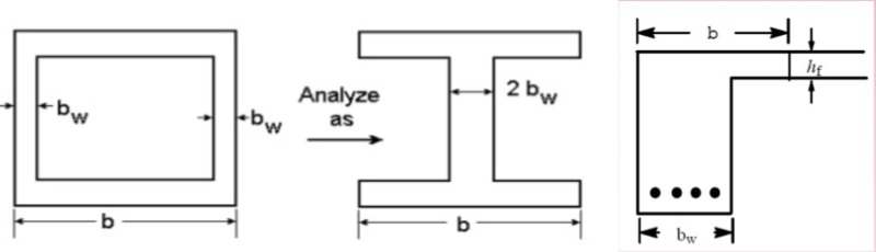

Yet, I appreciate if some experts guide me how to design it. I mean should I consider interior girders as T beam and interior girders as L beam? I do have the longitudinal and transverse demand moment and shear values from software. Now I need to get capacity values in such a way to have adequate capacity/demand ratio. For doing that, I need to know how I must design the RC BGB. Is what shown in picture below appropriate?

One of the nice things about using a grillage rather than 3D shell models is that it nicely outputs BM's and SF's for the types of sections you chose to represent the grillage with. You're on the right lines yes, make sure you take into account shear lag and the like in checking the structure. Obviously its crucial that the analogy you've used to analyse the bridge is compatible with the way you're designing the structure.
If you do use a grillage, do check whether a modified-grillage might be more appropriate for this type of structure (such as that for steel-composite bridges or precast concrete tub/U girders with an insitu slab). It might be the case that the basic grillage analogy is inadequate for this type of torsionally stiff structure
IIRC Chen's Bridge Engineering handbook includes some guidance on this type of structure as well.
Good luck!

thanks for your insight. As you mentioned, grillage analogy cannot fully model the behaviour of this type of bridge, since they're very stiff in lateral stability (torsion resistance). Grillage model of this bridge exists but the need is now for FEM which I have it already. The main point is I cannot figure out what design criteria (probably AASHO 1970) for this bridge was made. I was thinking to use longitudinal and transverse maximum demand moment and shear using H20-S16 truck loading and get the corresponding resistance capacity.
