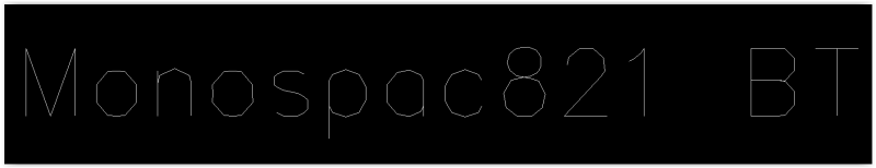

My ply patterns are in a Drawing as previously stated. In the drawing, I have named my ply and placed the text inside the ply. I want my gerber cutter to write the ply name on my plies to facilitate kitting. When I save my drawing as a dxf file, my gerber cutter program (CutWorks)does not recognize the text as text, but instead as part of the ply. It recognizes the text and ply pattern as one layer, instead of the ply pattern as one layer and the text as text (it wants to cut the text and ply pattern, it only allows for selection of one tool instead of giving two separate tool options, one as knife and the other as a pen).
Another programmer that helped us set up the machine was using AutoCAD and was able to use my dxf file to assign two different layers, one to the ply pattern and the other to the text. The text was assigned a text layer. This worked with the gerber cutter and allowed the pen option. He also ran into a similar problem as I did when he used text to write inside the ply (the gerber cutter wanted to cut the text), but he played with different fonts and eventually found one that the program recognized as text.
So my question is the following, what is the best text to use in CATIA with a gerber cutter so that text can be recognized in a dxf file?

Hello JeniaL,
Changing my settings to be just like yours worked. Thanks.
Is there a way to smooth the lettering using dxf? When my program reads the dxf file, it chops the lettering and its not smooth as it looked in CATIA.
I tried different fonts and the same thing happened. Thanks again, you've been very helpful.

i don't think you can smooth the text while exporting. look for some settings in your gerber software.
as for me, no matter what font i use, our Eastman software changes it. i don't really care if my font smooth or not. it's just a label on a ply.
