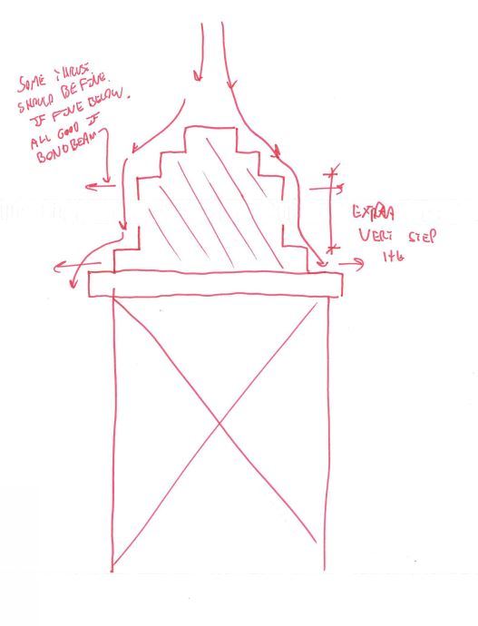

This question pertains to the design of lintels in CMU loadbearing walls that support precast hollowcore panels in multi-story buildings (i.e., “block & plank” buildings). It is common knowledge that lintels can be designed for only the loads within the triangular area below the apex so long as arching action can occur (block in running bond, a minimum of 8” of wall above apex, etc.). But what happens if the apex occurs above the level of the supported hollowcore? In many cases there is only 16”-24” of masonry between the opening and the bottom of the hollowcore above.
Option #1: Assume no arching action and design the lintel to support the full load of all levels above. This can result in a very heavy lintel and seems excessive.
Option #2: Design the lintel to support the full load of the level immediately above. Assume arching action occurs through the hollowcore interface so the levels further up can be ignored.
Option #2: Similar to Option #2 but the base of the triangular area is located at the top of the hollowcore. Arching of the masonry is assumed to occur above the hollowcore plane.
The fundamental question here is how does the hollowcore affect the development of arching action in the CMU? Which of the three design options is most appropriate (the attached PDF may be helpful)?

I screened down your sketch too much and the scanner didn't pick it up at all. I think you'll get the idea though. My thoughts:
1) Like Mike, I generally don't bother with arching. This is because I'm too lazy to evaluate the thrust capacity either side of the wall.
2) Like Jayrod, I feel that #3 is conservative and entirely defensible.
3) Were I a betting man, I would wager that the precast doesn't mess with the arching action at all. As you've detailed it, horizontal shear transfer through the precast is probably better than it is through the uninterrupted CMU.
4) I propose an option #4 in the sketch below. Basically, you would assume that the compression load turns vertical as it crosses the precast. Effectively, this shifts your load triangle up one block to create a two layer cake. Depending on how you look at things, this might also imply the need to deal with some thrust at the top of the precast but I don't see that as a deal breaker. If thrust works at the level of the lintel, it probably works at the top of the precast too. Also, if this were my baby, there would be a bond beam right above the precast and that would make the thrust moot point.

Thank you all for your input. I too typically ignore arching and design for the full load--not a significant cost driver for low rise buildings. KootK, I like your Option #4 and intuitively I agree that the hollowcore does not significantly impact the arching action (admittedly, I was trying to avoid doing the calculations to prove that we are right). There is a two-course bond beam upon which the hollowcore bears, poured monolithically with the lintel, and I do not know if that is what you are referring to. If not, making the first course that sits on top of the hollowcore a bond beam would certainly create a tension tie and allow Option #3 to develop. Again, many thanks to you all.

I think #3 with a bond beam above the PC really is your best bet if you need arching action. With #2 and #4, I see horizontal shear friction between the plank and the block below as the bottleneck. Shear friction stresses me at the best of times. And this isn't the greatest shear friction joint in my opinion.
