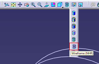

Hello everyone,
I have some 2-3 Solid bodies,But I am not able to see them clearly..I dont know how did this problem arise,In the below image,you can see than a solid body(Pad) exists in Design tree but I am not able to see that solid in the view.
Can someone please help me,I am only able to view edges,points of those bodies.Any settings to be changed?

Do you have the visualization mode as wireframe?

that looks like a graphic bug but as you work with Hybrid Design I am not sure...
please have picture in post and not link... use the following function

I reproduced this exactly, so it's highly likely the wireframe mode as suggested by Iscariot.
