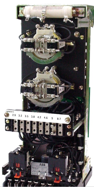

I guess I've been out of the field too long.
does anybody remember the Westinghouse IL for their HU relay?

A friend is working on some 'legacy', i.e., "older than dirt" equipment. He was specifically asking if the Westinghourse HU had a functionality similar to the GE BDD, where one can measure unbalance current on Terminals 8 and 9 to validate the proper setup of the unit.
Neither he nor I see that functionality in the HU.
It's been quite a while since I got to play with these things. My old service 'library' has disappeared, along with a good portion of my memory of this fine equipment.
old field guy
RE: Wstinghouse HU Xfmr Diff Relay
I'm not sure if this is what you are looking for, but as an in-service test he can measure the voltage across the 'operating circuit resistor' at the top of the relay and compare it to figure 16 on page 32 IL 41-347.1S

JG-
Yes, that will work. It's just that the GE relay has that function brought out to a couple of easily accessible terminals on the case.

It is the big resistor at the top, so the two wired terminals should be pretty easy to clip on to.
