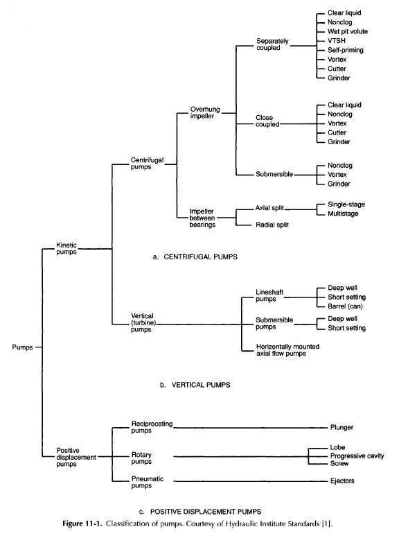

Pump nomenclature is not precise and terms are based on historical precedent and tradition. The term "centrifugal pump" is a generic term describing a basic pump. A turbine is a machine for producing continuous power in which a wheel or rotor, typically fitted with vanes, is made to revolve by a fast-moving flow of water, steam, gas, air, or other fluid.
As the pump industry developed, trade associations developed pump nomenclature. Pumps may be classified in many different ways. The Hydraulic Institute developed a nomenclature for pumps according to their design.
Turbines were invented much earlier than the invention of the turbine pump in the 1800's. The Francis Turbine was invented in 1848. It is an inward-flow reaction turbine that combines radial and axial flow concepts.
https://commons.wikimedia.org/wiki/File:M_vs_franc...
A turbine pump is a type of centrifugal pump.
