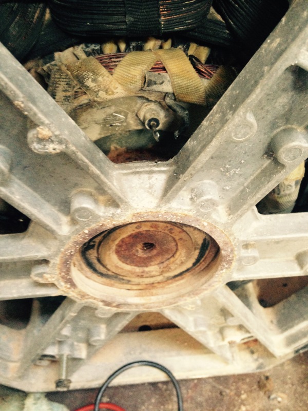

Great post above~! I am in the exact situation...I've got a genset here that someone has cut all the output wiring. I've been able to identify the coils and yes, I did have to disconnect the diodes on the rear to identify the remaining 3.
Forgive my ignorance here, but it was stated to excite the gen with AC. The Gen I am working on does not have any AC plugs attached...how would I go about exciting it??
Thank you all in advance!

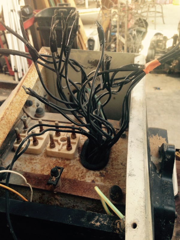

Apparently, everything I thought I knew, or have known does not apply to this particular project...I digress...I figured defining these wires is beyond my immediate expertise so I sought a repair company locally to define the wiring. Unfortunately, that has too, failed...so I am back to solving this myself...Please instruct my ignorance....
I have 26 wires that come out of this 3 phase (25 kw) generator. I know power output by the markings.
2 of them have electrical clips on them which I assume go to an avr. That leaves me with 24 wires.
What I've done thus far.
With an ohm meter, I've checked for continuity on all wires. 18 of these wires pair continuity which I have separated.(9 pair) I've got 6 left that I assumed went to the diodes on the plate. I disconnected the diodes and there is no continuity with anything having to do with the remaining 6 nor any pair I've found.
I've researched the crap out of how generators work to how they are wired and still find myself...elementary...logic tells me that I have 24 wires....math tells me that I should be able to divide by 2 and come up with 12 pair, divide again by 2 and finally sum 6 leads... in which, I could excite and find the phases. But as mentioned above, 6 wires remaining and no continuity or similarity exists with the tests I've performed between the 9 pair and the 6 nor the 6 themselves...
Am I doing something wrong? Is the generator head broken? The only history I have behind this unit is that I was told a diode was bad and a little diagnosing was needed to replace it.
I rarely give up anything to the mouth of a dumpster!! What do I do?
Thank you for any help!!

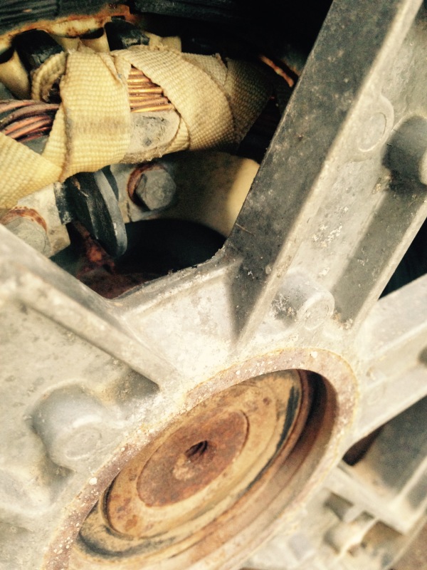

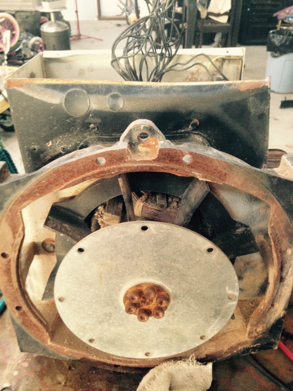

All,
If you think I can get somewhere with this, I will build a small wooden jig to correctly separate each one of the wires in order to keep organization testing the fields. Please see the enclosed photos.
The wires wrapped in orange are the mystery...
Mike, I do know of one more shop that I could take it to. I will call them and see if they can identify...
Thank you!
RE: Identifying Windings on 12 Lead generator
OK, so it's a 12 lead Newage, and 2 in hand by the looks of it.
First thing I'd do is add temporary numbers to all the leads
Next, is to megger test each lead to ground at 500 VDC, at a bare minimum you need to be above 1 meg-ohm, Newage prefers a minimum of 10 meg-ohms.
Next, use a DMM and measure each lead to very other lead, you should end up with 6 groups of 4 leads each that have continuity. If you don't have that grouping based on everything provided you have one or more open windings.
In my experience these chinese Newage tailends were terrible, where I worked at the time, we packaged a number of smaller rental contractor units with these and had a huge failure rate. Open windings were common, but grounded windings were most of the failures. Repair cost exceeded replacement costs and we ended up scrapping all of them in 2006 just before I left the company.
Attached is a Newage Fault Finding Manual you may find helpful.
MikeL.
