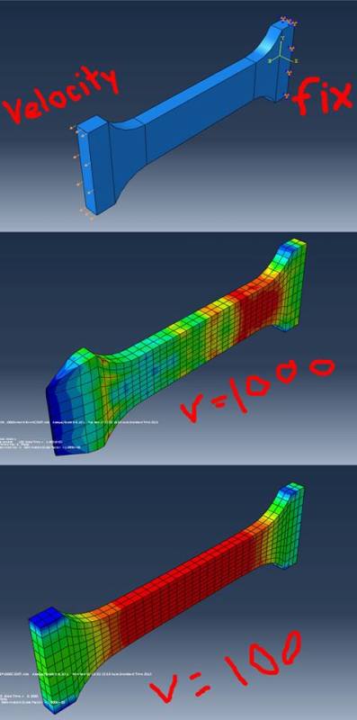

Hey guys,
I have a problem about the run Abaqus dynamic load for the tensile test.
Speciment has stretched in first element area(input velocity 1000 mm/s) and necking has not occured in gatelenght (input velocity 0.01-100 mm/s)
I use johnson cook model in plastic property and dynamic explicit mode.
thanks.
RE: How to simulations dynamic load for tensile test???
Have you tried a refined mesh?
Maybe you have to add a small imperfection. Your part might be too perfect compared to a real part.
I had similar problems once. My material density was off by a factor 1000. Could it be that?
