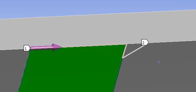

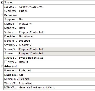

I use Ansys Workbench 16.2 to create geometry and to analyze it, but I generate mesh in ICEM.
I do following steps:
setting: Multizone, Write ICEM CFD: Interactive to create mesh in ICEM
delete ICEM blocking
create my blocks and mesh

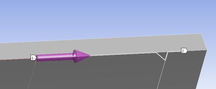

In Ansys I create a path along edge and sometimes I have strange path.
Wrong result (stress intensification) is where the path changes in direction.
If I don't clear ICEM blocking and I accept ICEM mesh, path is correctly calcuated.
Can someone help me?
