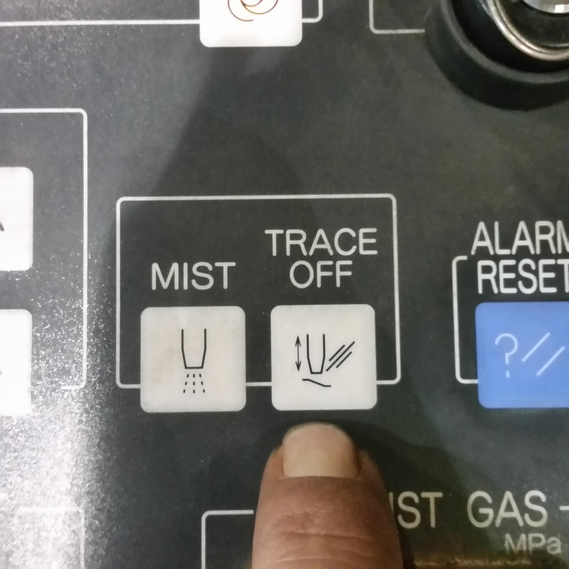

ok ThankS guys!... I tried and could only get it to pierce and then the head would start rising up I was told to turn off the sensor off did they mean "trace off" or how do I turn material sensor off?? THANKS GUYS!!
RE: MDF wood on an AMADA FO3015 Laser??????
or does anyone know of some written instructions on this??
trace button off.
Bring the head down manually to a height were you have sufficient nozzle clearance all over the sheet.
The Z value at this height is the height you enter into the material thickness setting.
It's the butting with a picture of a nozzle, up down arrow wavy line under the nozzle.
(above the WACS button, or middle row left side) hope this is clear enough.
the button must be light up for the trace to be off.
