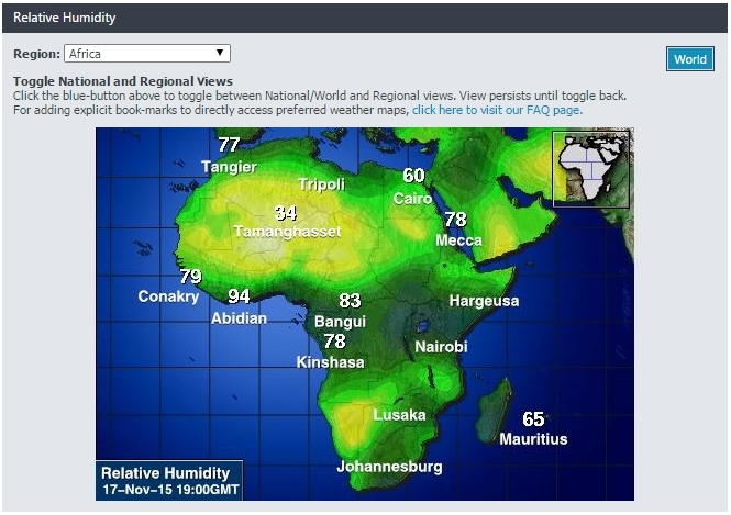

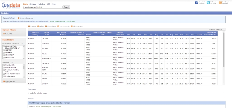

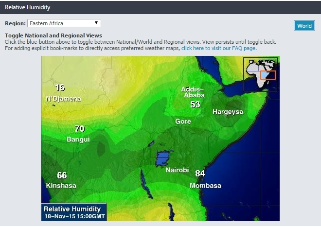

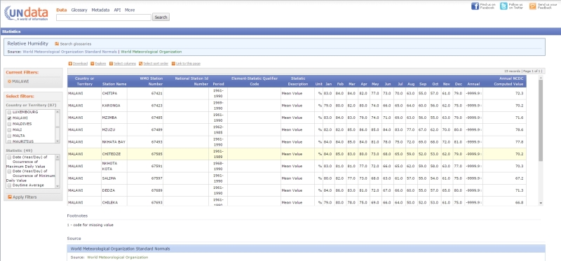

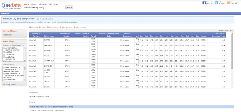

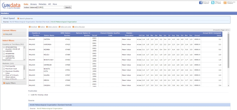

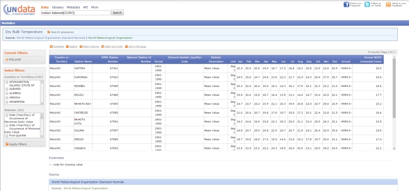

Historical local climate record data is publicly available at the UN and NOAA, which can used to get an general estimate for the exercise you want.
It seems the rainy/wet season lasts somewhere from Nov-Dec to Mar -April depending on the year. So I would expect a typical rainy/wet season to lasts 4 months.
see the links below
relative humidity
precipitation
temperature
wind
UN Data http://data.un.org/Explorer.aspx?d=CLINO
http://www.intellicast.com/Global/Humidity.aspx?re...
NOAA Climate
http://www.ncdc.noaa.gov/cdo-web/
