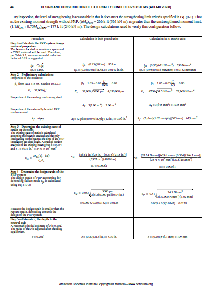

A good place to start is ACI 440.2 "Guide for the Design and Construction of Externally Bonded FRP Systems for Strengthening Concrete Structures"
There are several worked examples, with step-by-step details on the calculations, for example:
When starting out I always prefer to do hand calcs, or author an original spreadsheet, before venturing into third-party 'black-box' software programs.

Thanks for your input. I have the code ACI 440.2R-08 with me. My question is bit more basic that what should be my exact starting point in terms of data input. I mean I have a structure in front of me with loading (new loading) and some beam sizes given. I need the loading of existing structure (without additional column loads) and I need to analyze the overall structure in terms of moments applied and the capacity of beam required.
What in your opinion is the route should i take to embark on this problem?

Thank you very much PSEPK for your valuable input especially the names of books. I have gone through ACI 440.2R-08 and the example given there is excellent though skips some steps. I am well versed in STAAD and ETABS and can import drawings into these softwares for checking of structural capacity. Need to design each beam individually and detail them for their additional capacity using CFRP strips.
I also have one software from SIKA but that is too generic and isn't flexible about various conditions. Right now developing my own excel sheet so it will be easier to tackle future strengthening problems and also while developing sheet will learn each and every aspect of strengthening.
