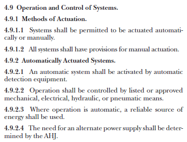

I was wondering if it is possible to use deluge valves when I design low-expansion foam fighting system (e.g. foam chamber). I am asking that because the standard for this type of systems is NFPA 11 and it does not include Deluge foam-water spray systems. I did not read in NFPA 11 about deluge activation.

It is a diesel tank that was to be protected with a low expansion foam fighting system. I would like to use the foam chamber with a deluge activation but I would like to be sure if this disagree with the nfpa 11

NFPA 11 covers the design, installation, maintenance, etc.. of the low, medium, and high expansion foam systems. The foam system includes the foam concentrate, storage tanks, water supply, air compressor, etc.. On the other hand, NFPA 16 covers the water systems such as deluge and pre-action which are used with the foam system. Therefore, as stated in NFPA 11 clause 1.3, it is not the intent of this code to cover the water spray systems (NFPA 16 covers them).
Since the foam you are using is low-expansion foam, you should refer to NFPA 16 to know the requirements of the water spray system you intend to use. Also NFPA 11 chapter 5 covers the requirements of the low-expansion foam system.

Hello,
Good day!
With reference to:
But I was just asking if it is possible to use deluge valves when I design low-expansion foam fighting system and if this agree or not with the nfpa 11. I would like just to know if there are any limitation of the use of deluge valve in low/medium expansion foam systems...
In my understanding, yes! you could use a deluge valve. It is not directly mention that you should use a deluge valve, but the requirement set forth by NFPA 11 can be satisfy by it.
Per NFPA 4.9 (see below)
Hope this helps,
PAtrick
RE: deluge activation in nfpa 11
Thanks a lot Patrick,
You confirmed my thought!
