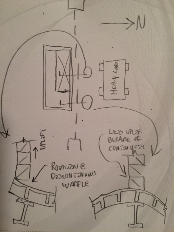

1. Would beam deflection result in a vertical crack, or is it more likely to cause a diagonal crack?
2. What would cause out-of-plane movement at the crack?

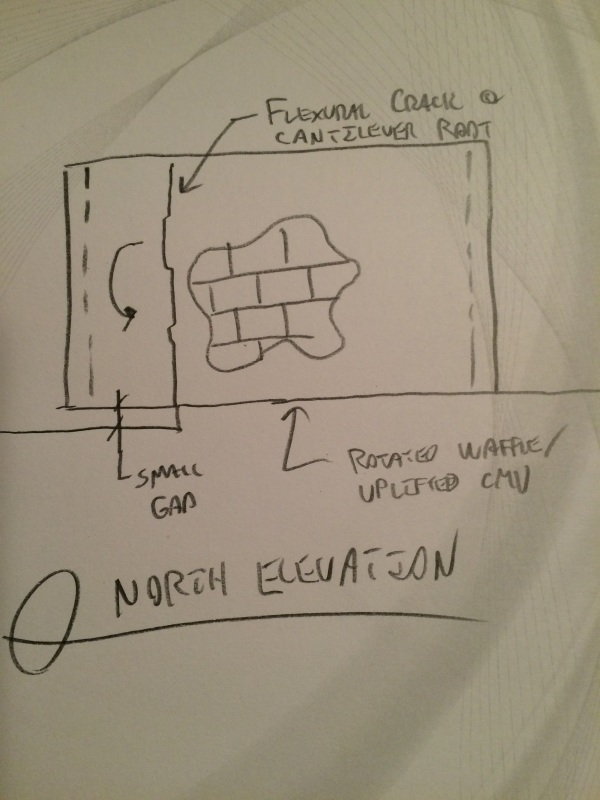

I don't have a high degree of confidence in this but it's an idea to get the ball rolling.

Interesting. I had thought of the floor rotation but I had not thought far enough to include the effect of the landing where there is continuity like you did. But would that produce a vertical crack or an inclined crack? And why would it produce the face shell spalling in the first course of block above the landing? And separation of the wall paint from the landing floor paint at the other 2 walls around the landing?

Great question. If it were a longer wall and I didn't know the history, I'd probably be looking at shrinkage restraint cracking for a vertical crack. That doesn't make sense to me here though. There are cases where a flexural crack can be vertical. If the cantilever dimension is short enough relative to the height of the wall, the load can probably arch down to the nearest support and a common flexural-shear combination crack may be precluded.
Quote (ajk)
I was thinking that the corner would have been lifted and dropped repeatedly via the mechanism depicted above.

The mechanism described above would lift the east wall and rotate the south wall as well. Is there anything to report at the west wall? And where abouts is the door into the shaft?

My feeling is that the crack has something to do with deflection because the crack I believe gets a little narrower at the top of the wall than at the bottom. Also, if the wall deforms as per your drawing, I would expect that this would cause the the portion of the wall to the west of the crack to be displaced northward relative to the portion of the wall to the east of the crack. The opposite is what I see on site.
