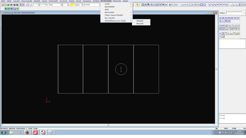

Import your part:
Go to Pre-Process> unfold reference line> setting

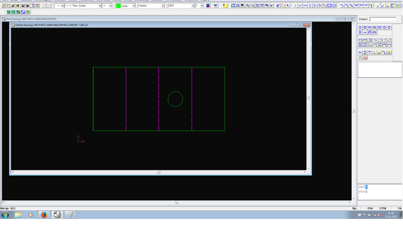

Select/drag the lines you want to etch. Right click after and press complete
This should make the lines pink.
After that, click unfold/merge all button:
Then save your part in the SDD. Open it in Dr.Abe, Those pink lines will now etch.

Creating a layer in autocad as etching doesn't work when making your drawing a part using this Amada software. When importing a part, unless changed, you have to specify what lines are cut and etched.
The example i posted above shows the etched lines made pink before confirming the 'outline' of the rest of the part to cut.
