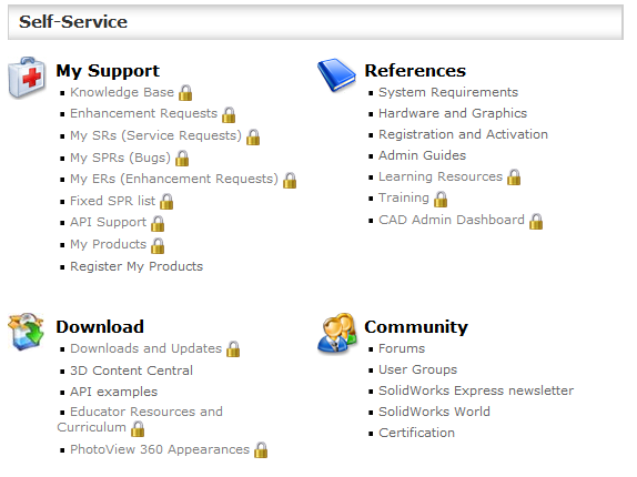

You must be on subscription to access the knowledge base. See attached.

RE: Custom property disappears after drawing renaming
Did you try to register the product? That should make some of those locks go away.
