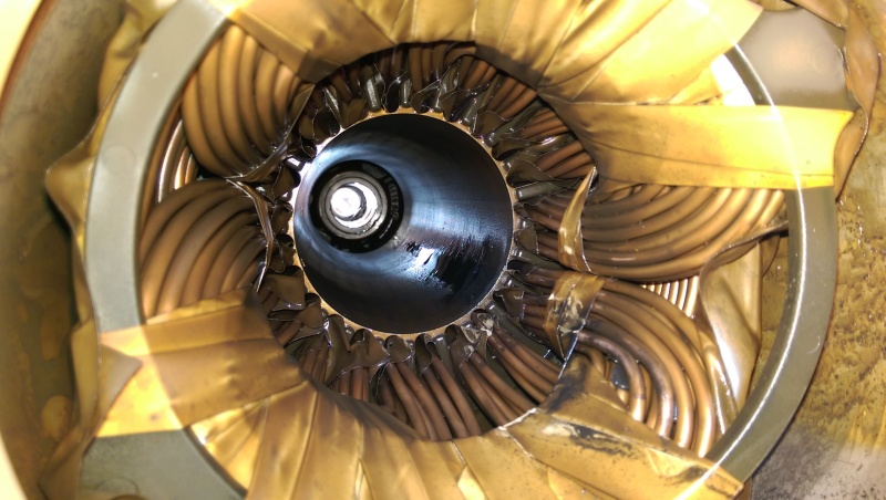

On August 9th, 2015 at 11:39 PM the panel operator noticed that Beach Well pump stopped for no apparent reason. It was noticed that a trip code indicates Fault code 17 (input phase loss). Prior the fault the Beach well pump was running at a normal rate with no process change. Trend graphs indicate that the Amperage was running at a continues rate between 98-102A and then suddenly went to 110A at the time incident. Trend graphs also indicate that the well-water level and flow were at an acceptable rate. Initial motor measurement indicates a shorted lead to ground which triggered a complete disassembly.
On disassembly of the motor it was noted that the rotor contained excessive damage and "flash"(see attached picture). As described below the motor runs in potable water which was tested during disassembly. Lab results indicate Salt water intrusion most probably from the well-water. Additionally, high turbidity and high iron content is also noted.
Your opinion and or observation of what could of caused such rotor damage will be highly appreciated. Many thanks for your support.

With nothing else to go by other than the pictures, it looks like a voltage stress event, as if the stator winding insulation failed and arced into the rotor, burning through its insulation. Hard to tell though.

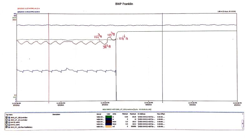

Thanks for the reply jraef. I have accumulated additional information. Motor is connected to a VFD an uses and output reactor. I have also attached the trend graph indicating Amps, Flow and Level. (Pump no. 120)
Graph can be viewed larger in the attachment.
1. Initial motor measurement indicates a shorted lead to ground.
2. Trend graphs indicate that the Amperage was running at continues rate between 98‐102A and then suddenly
went to 110A at time of incident.
3. Trend graphs also indicates that the well‐water level and flow where at an acceptable rate.
4. Voltage and frequency data are not recorded.

12. Rotor indicates excessive damage with concentration on the outer sections (refer to the attachment, page 5
and 6).

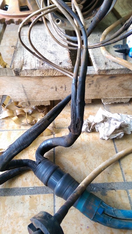

Thanks for the reply zlatkodo. The funny part is that the stator does not appear to have sustained extensive damage compared to the rotor. See pictures of the stator below (note that winding is dirty due to the arc flash of the rotor and well water entering the motor). Furthermore, recent findings indicate that at the winding connection leads the "rubber tape" appears to be pressed against the motor housing. Additionally, where leads have been taped it appears to stick together, most likely due to heat. See pictures below.

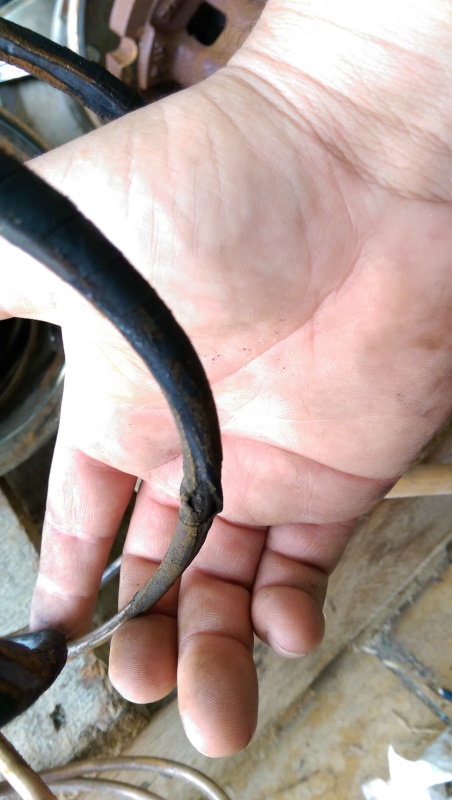

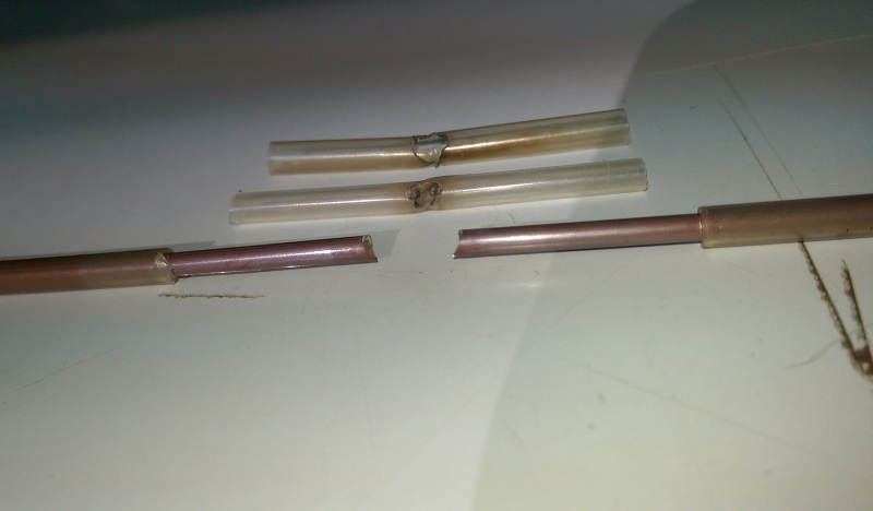

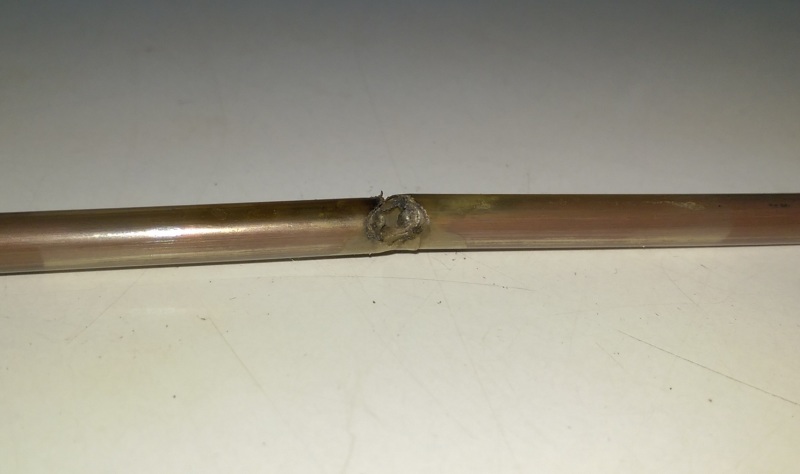

Hi all,
As a follow-up on the issue, me and my colleague decided to do a complete autopsy of the motor and determine where exactly and how severe was the shorted lead. After completely disassembling the motor and completely removing the stator winding, we found
one winding wire completely open and exposed copper true the isolation (see pictures below). A second defective winding wire were found showing signs of burnt isolation but no exposed
copper (refer to pictures below). I am not sure what could of caused such damage but do suspect sea water (incl. solid particles) entered the motor through the open mechanical seal. These particles got between the winding wires and created a hot spot which caused the burned isolation at two points (and caused the ground to earth fault). If any of fellow formers have additional suggestions or opinions please feel free to advise. Many thanks for your support.

RE: Problem with several Pleuger Submersable Motors
I saw similar damage to an underground conductor in a wet location. The cause may have been a pinhole in the insulation.
I suspect the insulation may have been punctured by a voltage transient.
The intrusion of sea water would hasten the failure.
