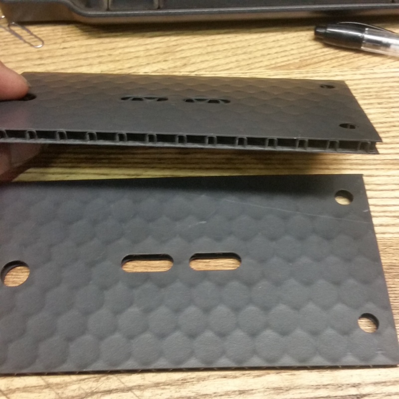

RE: Amada 2415 How to cut ABS?
Great cut, but the important picture is the one with the cutting parameters :)
