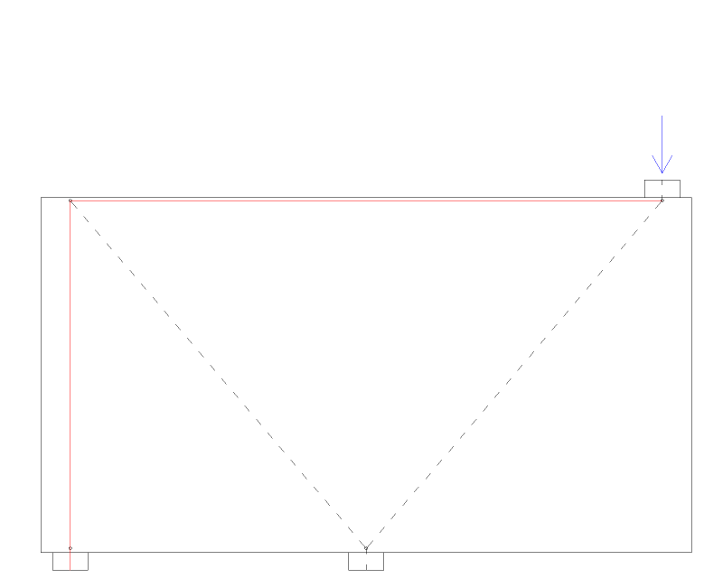

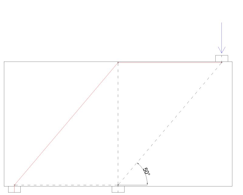

KootK, here are 2 models I came up with for this simple problem. There are no values added, except for the inclination angle of the strut, which is 50 degrees.
I would just like some qualitative advice on which one is better. I know the one with orthogonal Ties is easier to detail, but what other points are there as to which one is better.
Ties are shown in red, and struts are dashed lines.

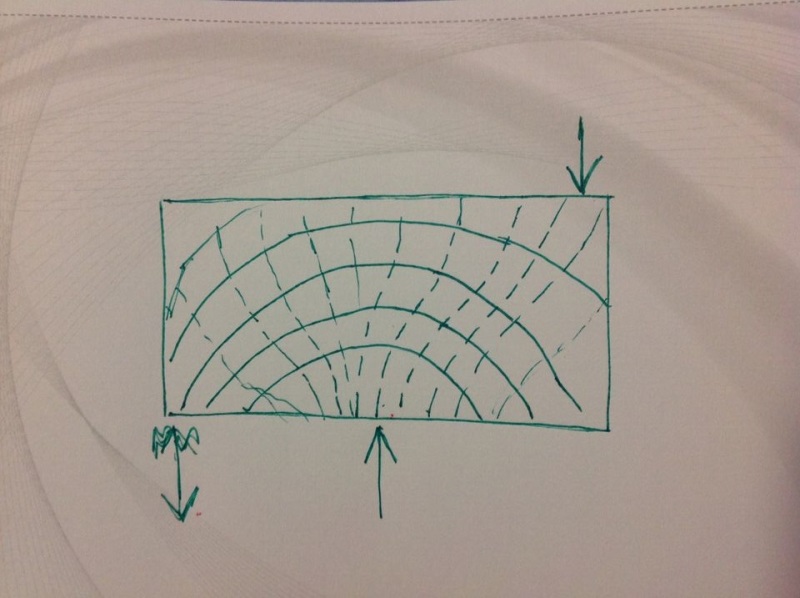

I would say that:
1) model #1 has a leg up when it comes to rational reinforcing layout.
2) model #2 has a leg up when it comes to matching elastic stress trajectories.
3) Point #1 weights more than point #2 so I vote for model #1 as the preferred option.
Take my stress trajectory diagram with a grain of salt. I suck at making them.

I'll throw in with Kootk.
Model #2 seems to match my experience with how the stresses will naturally want to be distributed. Because model #1 will "force" the stresses to make that hard 90° then your strut/tie loads will be a lot higher in model #1 vs model #2.
However, I agree with KootK that this will be a more practical rebar layout and also better represent the large compressive forces at the middle support. I'd go with model #2.
