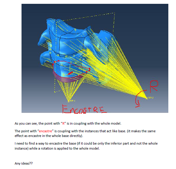

I am facing a problem that may be really easy but I can't find the clue.
I have a model of vertebrae C5 and C4 with the intervertebral disc between both.
I want to submit the whole model to a rotation. But I also want to encastre the base of the inferior vertebrae. My aim is to see the resultant moments.
I am using a coupling constraint between a reference point (situated outside the model) and the model itself. I use this reference point to rotate the whole model.
I am using encastre in the base of the vertebrae.
However abaqus exits with an error because nodes used in the coupling are also used in the encastre.
Does anyone know how to solve this problem?
Thank you very much. I really need help.
Please find attached a pdf with images.

Yes, you don't use nodes in the coupling if they are in the boundary condition.

The problem is that I need to submit the whole model to the rotation.
As I need to fix the base, there will be nodes of the base that will be in the boundary condition while they are in the coupling because I have to rotate the whole model.
RE: Encastre and coupling at the same time. Problem with nodes used twice
When you have to rotate the whole model, then what is the BC for?
What shall the nodes do that are in both definitions?

Then make sure that the two selected regions do not overlap. The job will start then.

Again, make sure that these two definitions do not overlap.
When some edges are part of these two regions, then you can easily fix that. Decide in which definition the edge(s) shall not be. Then edit that definition and select again the faces. Before you confirm your selection, press down CTRL key and click on the edges that should not be in there. Confirm that.

If you are trying to apply a pure moment at the top vertebra so as to replicate a typical pure moment flexibility (ex vivo/cadaveric) test (as per Panjabi and White), then you should couple all nodes at the top vertebra to a reference node (as you have done at the bottom surface of the lower vertebra) and apply a rotation (only) about a given axis at this new reference node.

Remove the encastred nodes from the set when you select the face or whatever. Simply hold down the shift key and pick out the edges or faces that aren't to be coupled.
