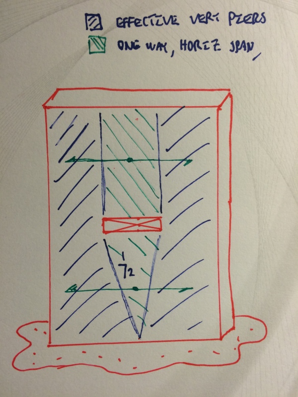

Hello,
I am working on a 16in thick CIP concrete firewall for a transformer and need to account for a roughly 10' wide by 2' tall penetration about halfway up the 40' wall. Obviously I am concerned with losing 10' of vertical reinforcement and I need to make a force pathway to either side of the opening. I understand the basic premise of providing extra reinforcement as well as corner bars to form a 'force arch' around the penetration.
Previous projects seem to have used software models to determine the reinforcement, however I always like to have a hand calc to go with that as a sanity check. I can take a stab at producing a calc, however I would love to see if you have any recommendations. Can anyone point me to a reference that deals with this situation, or how you have dealt with proof that your penetration reinforcement was sufficient?
Thanks for your time.

Standard opening detailing probably isn't going to cut it. How much wall do you have on either side? Do you have return walls at the ends?

It is quite a wide opening, therefore, I would do more than standard extra reinforcement around the opening. I would probably set up a small FEM model of the wall, using all applicable loads.

Thanks for the replies. There is about 10 feet on either side before hitting the firewalls that run perpendicular. I was going to show in the calc that additional steel provided along the penetration was sufficient to withstand the bending moment of the wall above the penetration. Just wondering if there's other factors that I am not thinking of.
jike, that's the go to for the people around me as well, and I likely will do this - just wondering if anyone has approached this without a model as I know it's been done. Thanks!

Manually, we would probably transfer the load from 1/2 the opening plus a portion of the continuous wall (say 2') to a vertical strip (say 2' wide) and determine the required reinforcement to span full height.
Do a similar thing for the horizontal span.
The FEM model is the simplest and most accurate.

Based on your proportions (30WX40H), I'd span the wall horizontally in which case the horizontal opening would become pretty much irrrellevant.

No reason wind load can't distribute through horizontal spans too. I suspect that your FEM model will comfirm horiz spanning as the dominant structural action. Your solid side panels are really in the "flexurally useless" zone as far as vertical spanning goes.

Oh, I understand. I agree with you if I were designing the wall considering it as a beam between the two other walls. However, I am designing it to be sufficient freestanding in case the owner would like to remove the other walls in the future. I should have clarified that when you asked about the other walls earlier. The model will just have the mat foundation and the one wall with the opening.

I agree with KootK's approach. It seems ridiculous to design that wall to be freestanding, and if it is to be cantilevered, 16" is probably not enough.
Using some FEM program to design this wall would solve nothing...you already know there will be stress risers at the corners of the opening.

Ah. Then, somewhat similar to Jike:
1) above the opening, treat as two 10' wide wall piers with all loads on the wall segments between spanning out to them.
2) below the opening, you've got enough meat that the load can probably spread back towards the middle. This could be handy as you'd essenntislly be back to a full section in flexure,

At 40', she is a very tall cantilevered wall. Were I to do it that way, I'd be envisioning something like this.

KootK - thanks for the sketch and your input. Very helpful
