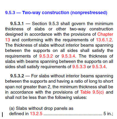

On ACI 318-15 it's said we can multiply the immediate deflection for a value, for flexural members.
I see 2 problems here, first it means it's for flexural members, altough slabs are also flexural, i'm guessing this is for beams since in the following page there's a minimum thickness for 2 way construction.
The second problem is that, considering the 1st picture, for a cantilever slab with 2m of lenght and 5 years or more you'd get something like
multiplyfactor = 2 / (1+50*2) = 0,019
Which is a very small value when compared with the factor "3" that I've read around.
I apologize if my maths are wrong, I studied the EC2, not the american guides.
