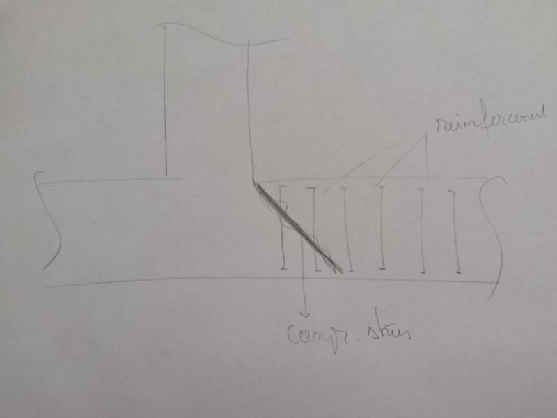

I didnt made my self clear, yes i know what you said, but my question is : why is this limit ? why they limit the compression stress in the strut ? what happens if this fail ? especially in the punching shear case. Because the way i see it if the strut fails we have the reinforcement that will carry the stress.
PS: I draw a picture :

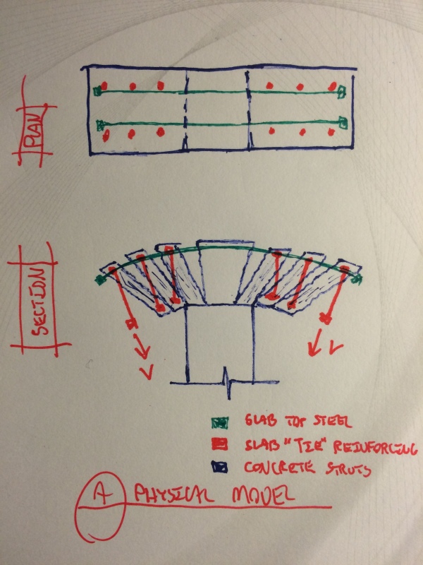

There appears to be a fundamental misunderstanding in your thinking here. Concrete reinforcement generally does not resist load by itself. Rather, it resists load in concert with the concrete struts that restrain the ties. And those struts still have practical strength limits even when the ties are present.
The situation is analogous to that with stirrups in a simple beam. Imagine what would happen to the tie/stirrup reinforced beam shown below if the concrete struts (dashed lines) gave way. All of the rectangular panels between stirrups would rack in shear and the beam would collapse.
RE: Punching shear check - question
Yea i guess i have some trouble understanding shear in concrete beams... Can you detail more please "Rather, it resists load in concert with the concrete struts that restrain the ties." ?
You bet. Concrete shear is pretty mysterious stuff.
In the sketch that I posted above, the steel ties and concrete struts work together, in concert, to form a truss that resists load. If you removed the struts from that truss, it would no longer be stable/viable.
If that doesn't help, let me know. We'll get it cleared up if takes 100 sketches.

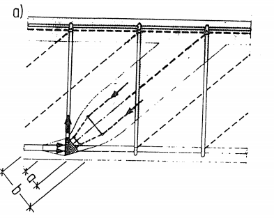

Some more from a more reputable source (Jorg Schlaich).
Hehe, thank you very much !!!! Now i have a better understanding, thank you KootK
