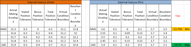

Assumed the hole and the pin are nominally coaxial.
Minimum gap is when both hole and pin are in their virtual condition, since virtual condition is maximum material boundary that shall not be violated considering feature's MMC size and maximum allowed position tolerance.
Thus, Min Gap = (31.2-3.7)/2 = 13.75

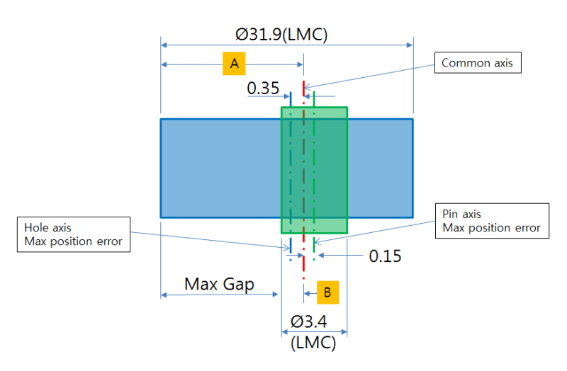

Maximum gap would be when both hole and pin are at LMC, in addition, considered that axis of hole and pin are displaced in opposite direction by the amount of maximum allowed position error,as shown in below figure.
Thus, Max Gap = A-B = (31.9/2+0.35)- (3.4/2-0.15)= 14.75

Woosang's calculations will work under one condition - both FOS in question, internal and external, have to be located relative to datums that in assembly get perfectly aligned with each other and no shift/movement between them is possible. In other words, if two parts, one with the hole and second with the pin, mate with each other such that a loose between them is possible, the amount of that loose has to be taken into account in the calculations of min and max gap between the pin and hole.

so, the minimum gap = Int VC/2 - Ext VC/2
the max gap = Interal RCB/2 - RCB/2
