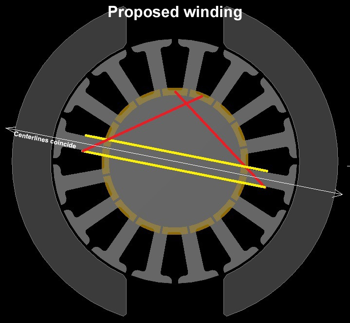

I might be on the wrong track because I was gonna do the opposite of what you suggest. However, there is another factor I forgot to mention. The motor was originally designed to run at 100% duty on 24VDC with a fixed load. However, I will be running it with varying load at up to 36VDC.
To handle the extra voltage, I figured I needed more resistance in the coils and so decided to re-wind it with wire that is 1 gauge size higher. From what I have read, that change will cause a drop in amp demand, but will increase the magnetic flux density, so the torque output will be roughly the same or maybe a little less. But the higher voltage will provide the higher RPMs needed which is worth the trade-off. The original configuration was 21AWG 155C wire - 9 turn double (each segment is wound with 2 parallel 9 turn coils). I am going to wind it with Essex 22AWG 200C wire - 12 turn double which should give me 10% more copper fill (There was plenty of extra space for more copper in the original configuration).
But none of this really answers my question.
Is there a reason that the motor was originally wound such that the armature coils' poles do not directly line up with the permanent magnet poles?
Here are 2 pictures illustrating my question:
The red lines represent the wire path to and from commutator segments. The yellow represents the coil winding.
I did spend a little time drawing the coils in MS Paint, but I already had the armature and other parts modeled in CAD to aid in calculating the winding fill area.

I have no answer to your question, but if you find that every motor is wound contrary to your theory of motor winding it is much more likely that your theory is wrong than that every motor is miswound. Maybe as simple as the asymmetry is necessary to get the thing to start spinning in a known direction at start. That certainly seems to be worth a bit of theoretical loss of efficiency.

1. "a drop in amp demand, but will increase the magnetic flux density" Not in the real world.
2. You seem to be using the terms winding and coil interchangeably. Not so. A winding is a group of coils. The difference is important.
3. You assume that the use of fractional pitch is a design compromises to facilitate automatic manufacture. Not so. That pattern of winding has been around for a lot longer than automatic winding machinery.
But winding pitch is what you are asking about. Winding pitch is a design compromise, but not to facilitate automatic construction.

Fractional pitch:
Quote (Nadon and Gelmine)
If the pitch is too small, an appreciable reduction in generated EMF Results.
(in a motor, back EMF)
However
The fractional-pitch type of winding is in general use, because it produces less sparking and because it requires less copper, which means lower armature resistance.
It seems as if this design compromise may improve performance while reducing the amount of copper required.

I think that the wire is wound offcenter because the armature`s shaft stands out at both ends so it needs room

An armature winding that includes 7 of a possible 8 segments is called a fractional pitch winding.
I don't know how long it takes for a winding scheme to achieve "General use" but fractional pitch was in general use in 1939. (Long before Wiki by the way.)
In case anyone missed the fine print:
Quote (Nadon and Gelmine, Industrial Electricity copyright 1939)
