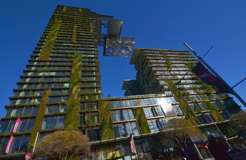

Sorry, I cannot help you with any advice, but the subject matter does remind me of the new building across from the university I once attended:
