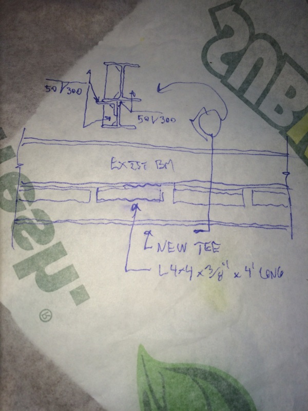

I think that's doable.
I always wonder about fit up given that both members are likely to have natural camber and one is likely to have some deflection, even if jacked.
Perhaps:
1) make backer bar permanent structure and intermittent.
2) move backer bar to other side of stem.
3) connect backer to existing with fillet welds each side.
4) connect tee to backer with fillets one side.
5) throw in stiffeners at 1/4 points-ish
I've never done this but suspect that it might be rather field friendly.

I don't understand KootK's (2) above.
I would be inclined to do it as ajk1 suggests except that I would prefer a small angle rather than a plate or bar. That would tend to preserve the right angle a little better.
BA
RE: Plastic Moment of resistance of beam with welded tee at bottom
ok, thanks. I take it that if I change the plate to a small angle, that it would still require a full penetration butt weld between the stem of the tee and the flange of the beam above.
The small angle would serve as a backer which permits a full penetration weld. The angle is not structural. You need enough weld to develop the yield strength of the tee section. The weld does not need to be continuous.
It might be a good idea to add nominal stiffeners between the flange of the beam and the tee, although it could be argued that they are not required.
BA

A couple of additional reasons why I pitched a solution not requiring full pen welding:
1) It's kinda hard in the vertical position.
2) Depending on how much of a stickler you are for weld inspection, considerable inspection costs could be eliminated.
to Kootk: I am not sure that I am understanding your sketch. You seem to be welding on the blind side of the existing beam as well as on the accessible side. Are you saying that if the angle is shop welded to the new tee, that intermittent field fillet welds to the existing beam flange one side of the angle is sufficient?
What are the stiffeners doing, and what spacing are they at, or are they only at the ends. I don't see any mention of stiffeners in Newman's on-line notes.
Quote (ajk)
The angles would be shipped loose and I'm assuming that the heel side fillet weld to the existing beam is achievable. You'd need to do it anyhow for the backer bars although, admittedly, you'd be much less concerned about the weld quality in a true backer bar attachment. The tee would only be welded to the angles on the freely accessible side.
Quote (ajk)
I was proposing welding the angles into place and then, subsequently, welding the tee into place. As I showed in my crappy sketch, the angles would be welded to the beam in two locations. However, it would be the heel weld that would be doing all of the work.
Quote (ajk)
The stiffeners would be stabilizing the Tee. They would be particularly relevant with my proposal as the tee would only be welded on one side which would introduce a small amount of eccentricity to things.
Quote (ajk1)
See figure 3 for an example: Link
ok, I think I understand.

The penetration welding was because there is access from one side only, so I was going to weld a backer bar at intervals on the tee stem before lifting the tee stem into place . There is a parallel block wall located about 2" to the south of the beam flange. I don't think it would be ok to just fillet weld one side (the accessible side) of the new tee stem to the bottom of the existing beam....or would it (although it would simplify things)?
No, fillet welding only side would be a very poor detail, I got quite sidetracked. Maybe stitch CJP if possible? This takes a hand calc to figure out though, not aware of any software that will work it out for you.

You seem to be summing the shear force over the unreinforced length from the end of the reinforcing tee to the end of the beam, to determine the weld near the end of the tee. Why would that be?
That's exactly right ajk1. Graphically and physically, that's what MQ/I "is". Think of it this way:
1) if you extended your reinforcing full length and specified a ridiculous weld spacing that perfectly matched shear flow demand, you would have just enough weld to develop the force in the reinforcing on either side of the peak moment location. The math just works out that way.
2) if you now cut the reinforcement short and leave the welds as they were, your total weld capacity would now fall short of being able to develop the required force in the reinforcing. And the shortfall would be exactly equal to the shear flow demand that would have otherwise been present between the end of the reinforcing and the end of the member.
3) The MQ/I-ish termination welds represent the reinstatement of the shortfall described in #2.
I'd like to revise my "what to do" recommendations to this:
1) Do VQ/I along the length.
2) Do MQ/I at the ends if partial length.
3) Do the tension lag extension that we discussed.
This strategy will be simple, reasonably efficient, and conservative for all cases where section plasticity is involved. And the requirement to fully develop the peak flange force will be automatically satisfied.
I've come to feel that developing As x Fy uniformly may not be the best way to go. That strategy would make the full, reinforced section available to you at the location of peak moment demand but, possibly, nowhere else. Presumably, you want the extra strength and stiffness available to you along much of the length of the member. For that assumption to be valid, I believe that the reinforcing section needs to be developed for MQ/I-ish forces beyond the theoretical cutoff points.
I'm with you Kootk. Develop the WT (or cover plate) with enough welds on each end and then size the stitch welds for the shear flow / unbraced length (compression plates).
A lot of piece of mind for a little extra weld.

Thanks Kootk for a clear point by point description. Much appreciated. I am not sure why the end weld has to develop all the shear in the length of unreinforced beam beyond the reinforcing plate. We don't do that when the bottom bars in a concrete beam are terminated short of the beam end...or do we? I'll check the Code. Anyway, I am not doubting what you say, I just need to do some thinking to understand it.
Thanks MJB35. That is almost always my approach...be conservative. Then can sleep better at night.

Is there anything wrong with using VQ/I throughout the reinforced portion of the beam in order to determine the amount of weld required at every section?
BA
Quote (BAretired)
Yes, for partial length reinforcing scenarios, I believe that there would be something wrong with it.
If the reinforcing extended full length and one provided exactly VQ/I the whole way, then the aggregate horizontal shear transfer capacity would exactly balance the force demand in the reinforcement at the location of peak moment.
If you cut the reinforcement short, and the horizontal shear attachment along with it, then you would not have enough aggregate shear transfer capacity to balance the force demand in the reinforcement at the location of peak moment. The shortfall would be MQ/I.
The above pertains to an elastic system but the same logic would hold were plastic section capacity required.
In order to develop the full tension in the tee, the weld must resist As.Fy:
t.L.Fy/2 = As.Fy (this assumes the full pen weld strength is Fy/2)
so L = 2As/t
where t is the stem thickness of the tee and L is the total length of weld required
For a WT180x32
As = 4070 mm2
t = 7.7 mm
L = 2(4070)/7.7 = 1057 mm
If the length of tee is 8m, the half length is 4m and the average length of weld required is 264 mm/m. If we assume the same provisions as CSA S16 specifies for composite action (shear studs may be placed uniformly between the point of zero moment and the point of maximum moment) then we could use 110mm of full pen weld at 400 mm o/c.
Alternatively, recognizing that full pen welds are not as flexible as shear studs, if we want to ensure that the shear flow is adequate at every section, we should space our welds at 400 mm o/c and use a length of weld varying from 220 at the end down to 0 at midspan. Of course, some reasonable minimum would apply, say 50 or 75 mm.
