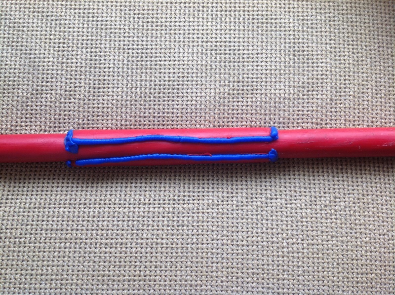

My application is 2.0mm thick HDPE tubing of 16mm diamater where I wish to weld a longitudinal seam.

By way of follow-up, I sent a sample to one of the manufacturer's resellers and they conducted a trial weld and returned the sample to me:
