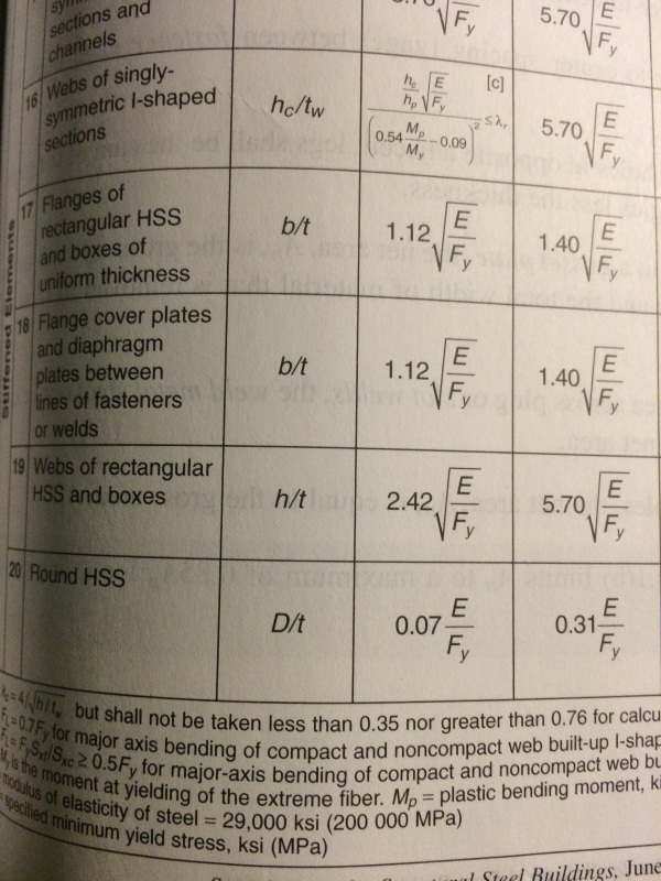

Thanks KootK. you're not wrong about keeping busy!
just wondering if you could help with #2? point in a direction to help me consider this?

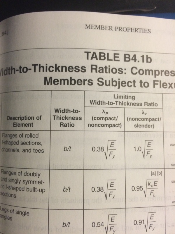

I don't have an Aussie steel code I'm afraid. Here's what the US AISC manual has to say:
RE: Torsion on Pipe
KootK with the goods! Thank you so much.
Regards, Joe.
