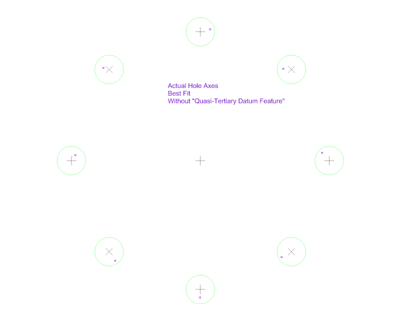

Pmarc is completely correct. But I was thinking about why the requirement is tighter, and it's kind of hard to explain in words. Pictures are so much easier. So here are a couple of figures that show why adding a "quasi-tertiary datum feature" becomes a tighter requirement. The crosshairs are the true positions, the green circles are the tolerance zones, and the points are actual hole axes:
In the best fit scenario, the 12:00 hole deviates mainly in the clockwise direction and some other holes deviate counterclockwise. But all of the holes are inside their zones.

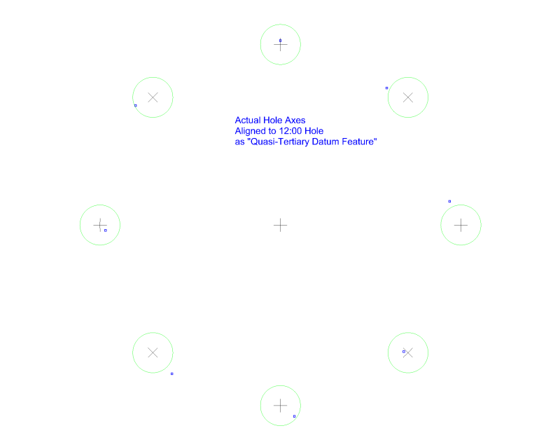

If the 12:00 hole is added as a tertiary datum feature, we can't "balance" the extreme clockwise and counterclockwise deviations anymore. We must align the pattern to the 12:00 hole, to give it zero deviation in the clocking direction. Then some of the other holes are too far counterclockwise and fall outside their zones. This is an example of what pmarc described.
